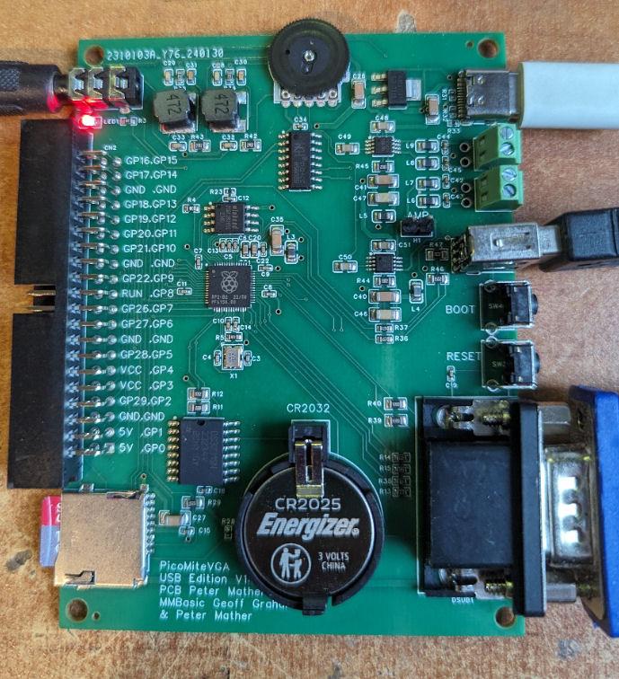

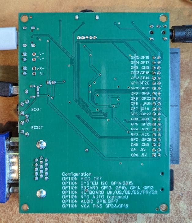

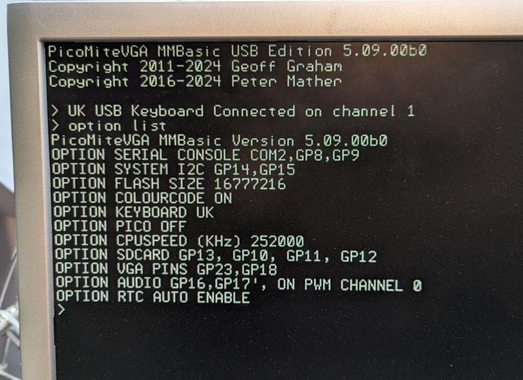

The boards have arrived and everything works perfectly
All the design files for the PCB are on https://github.com/UKTailwind/PicoMiteVGAUSB just upload to JLC and get some made!

Because I can use all 30 pins I'm allocating two pins that are normally unavailable on the Pico for VGA. The other normally unavailable pin is GP29 which is an extra ADC pin so I have left this in the general pool. It just means there are more of the "normal" Pico pins available for general use.
Just to confirm the spec:
RP2040
16Mb Flash memory
VGA
Line level audio output jack
Stereo PAM8302 amps and speaker connectors
DS3231 RTC with CR2032 battery backup
Support for USB keyboard, mice, and PS3, PS4, and SNES/Generic gamepads.
All Pico GPIO pin broken out  + GP29
CH340C to provide serial console on GP8,GP9
Edited 2024-02-08 21:52 by matherp

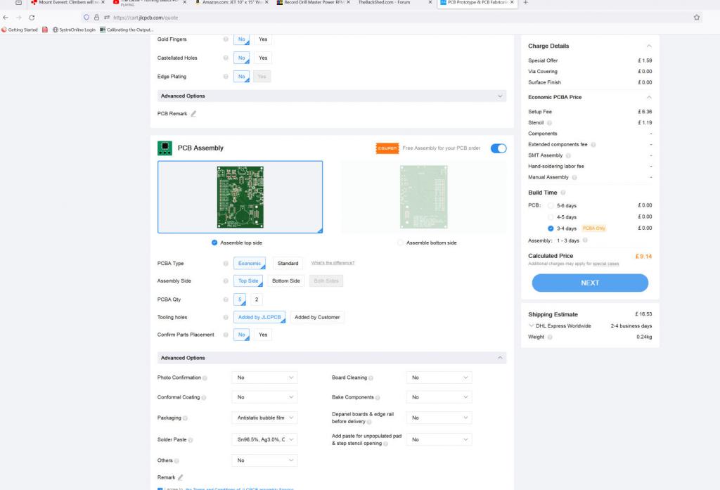

I'm uncertain of the ordering process for completed boards. I uploaded the gerbers and got the $2.00 for 5 bare PCBs--as I've done many times before.
I clicked on "PCB Assembly"--that added $8 for "Setup" and $1.50 for "Stencil"--and nothing for "Components". This comes to a total of $11.50USD for 5 boards excluding shipping. This doesn't seem possible to me, but I don't see what further I should do. Also, if it doesn't include components, I don't understand what it provides over the $2 option.

Posted: 02:54pm 08 Feb 2024
On the right side of the screen click the next button
Posted: 03:32pm 08 Feb 2024
Ok, thank you. After "Next", I clicked on Bill of Materials (BOM) and Pick and Place. Cheapest untracked shipping was only $2 less than DHL, so I went with tracked and fast. This did not include the 2x20 header, but I have those in various configurations--male and female, right angle and straight, shrouded and un-.
Total for 5 PCBs was $119.23USD after a $9 "SMD" coupon discount.
I will probably be looking to sell three of them--buyers in the U.S., Canada, or Mexico--at cost, so $24 + shipping rounded up to the nearest dollar.
Interesting to note that the DS3231s cost nearly 3 times as much as the RP2040s--$14+ for 5 as opposed to $5+ for 5.
Edited 2024-02-09 01:34 by lizby

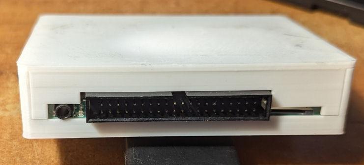

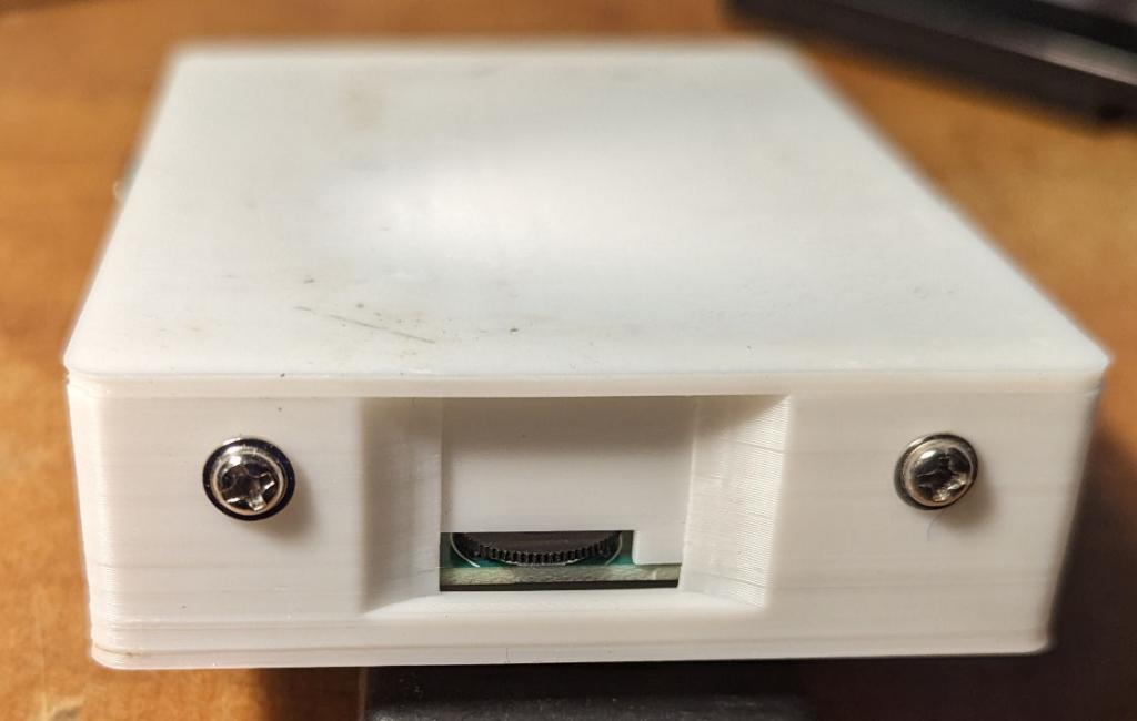

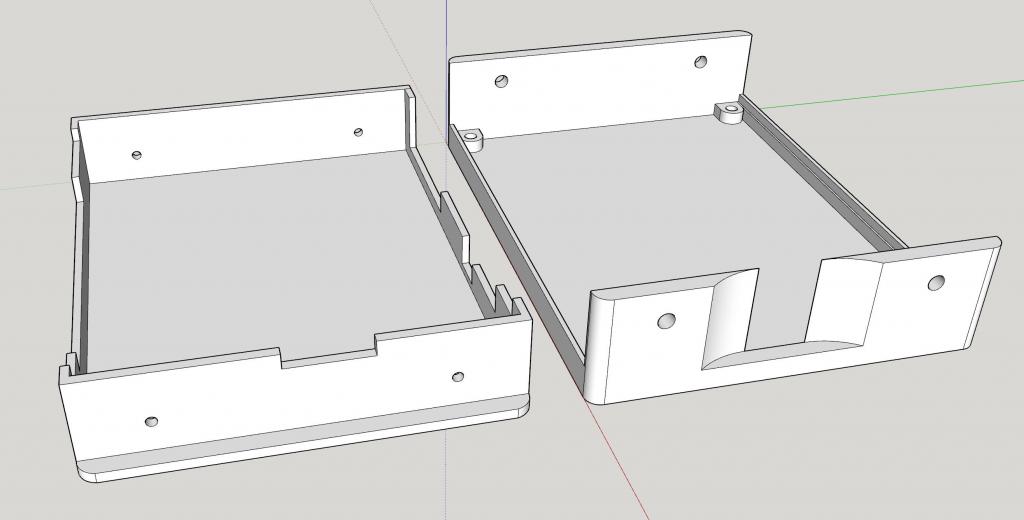

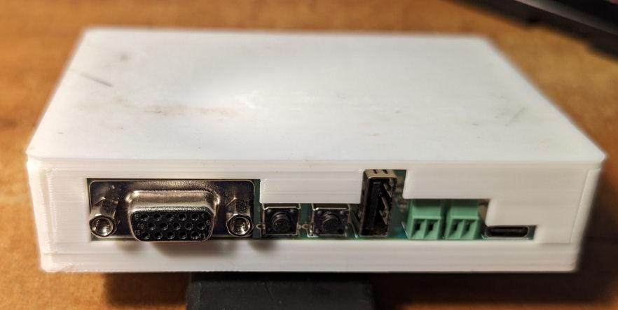

I've designed a simple 3D printable box for the PCB. STL file is on github. If you haven't got a £D printer, just upload the stl to JLC and let them print it for you.
Posts: 9246
Posted: 06:24pm 08 Feb 2024
I've designed a box made from an A5 sheet of 2mm ABS and a A6 sheet of 3mm acrylic. We'll see how it works out. :)
I like that one though.

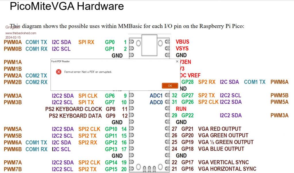

Schematic PDF is corrupted?
I get that message, when I try to open the PDF from the github download.
You can ignore the PM VGA manual PDF showing in the background.
I will order some of these to play with.
EDIT: Can't open the gerber zip either.
Windoze says the zip is invalid.
7zip says: "Errors: Is not an archive."
Has anyone else been able to download the files from the github link without issue?
Edited 2024-02-15 13:21 by Grogster
