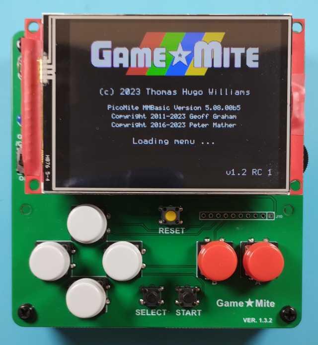

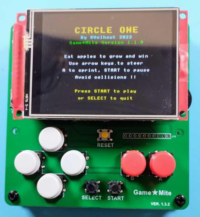

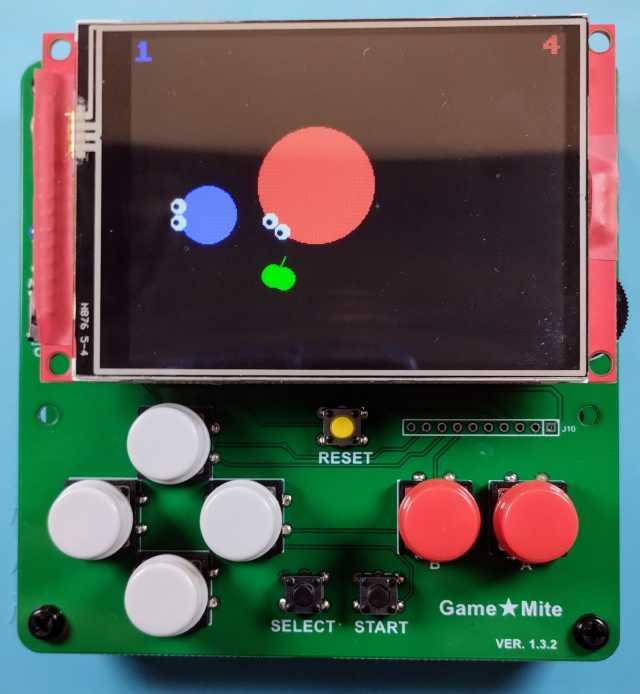

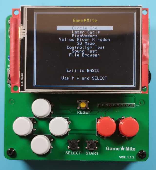

Hey folks,
This is the best I can muster in the way of a Christmas present:
   https://github.com/thwill1000/mmbasic-gamemite/releases/download/v1.2-RC-1/GameMite-1.2-RC-1-full.uf2.zip
Version 1.2 RC 1 - 21-Dec-2023:
- Updated to use standard PicoMite firmware (5.08.00b5).
  Required options are:
    OPTION SYSTEM SPI GP6,GP3,GP4
    OPTION AUTORUN 1,NORESET
    OPTION CPUSPEED 252000
    OPTION LCDPANEL ILI9341,RLANDSCAPE,GP2,GP1,GP0
    OPTION TOUCH GP5,GP7
    OPTION SDCARD GP22
    OPTION AUDIO GP20,GP21
    OPTION MODBUFF ENABLE 192
    OPTION PLATFORM "Game*Mite"
- Changed menu program to support multiple pages and be configurable
  via the "A:/.gm-menu" file:
  - This file will be created on startup if not present.
  - CSV file with entries of the form:
      <menu-text>,<file-path>
    e.g.
      PETSCII Robots, B:/mmbasic-robots/robots.bas
  - If the <file-path> is not absolute then the program will look first
    in "A:/GameMite" and if not found there, in "B:/GameMite".
- Changed startup screen to include image/logo
  - and made easier to configure via ".startup" file.
- Added @Volhout's "Circle One" game (v1.1.0) to the program suite.
- Updated program suite to use latest version of 'splib':
    System software => v1.2 RC 1
    PicoVaders => v1.1.2
    Yellow River Kingdom => v1.1.1
    3D Maze => v1.1.1
- Reduced size of program suite through better pre-processing.
Thank you to @Volhout for "Circle One" and @vegipete for the splash-screen font/logo.
Alas it appears I get worse, not better at taking photos:
Merry Christmas & Happy New Year,
Edited 2023-12-23 00:01 by thwill
Posted: 12:49pm 22 Dec 2023
Photos look good!
Posted: 12:50pm 22 Dec 2023
  JohnS said  Photos look good!
You should see the ones that @bigmik takes, he could have done that for a living.

Hi Tom,
The circle game works nice. You can even run diagonal now (=new).
Thanks for implementing.
You (and Kevin/Martin) did a great job. I just copied petscii robots on the SD card, and could play it when started from the browser. This is the first time I see it being played on an LCD. I will look at adding it to the Game*Mite menu. Thank you (all) !!!

Posted: 12:34am 23 Dec 2023
Hi Tom, Volhout, All,
Great effort there, I have just played circle one for 10 minutes (I lost but I was keeping pace for a while there). I love the sound/music in that game.
As to my picture taking, well I have done it for a long time and I generally take at least 6 pictures before I am happy with one and then I do extensive photo-edits to bash it into shape. I concentrate on the focus of the text and then try to minimise reflections on the screen and shiny PCBs. This usually means taking a picture at a slight angle and needing photo editting to skew the image back to the shape and size it should have been. They don't always come out as I hoped.

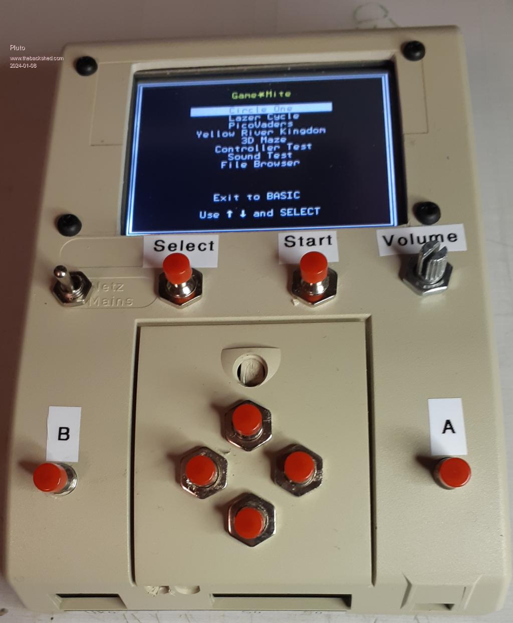

Loved by grandchildren (and older generations):

  Pluto said  Loved by grandchildren (and older generations):
Neat.
I'm guessing that must be a clone and not @bigmik's PCB ?
What's the enclosure, not a 3D print by the looks of it ?
I'd love to see inside.
Edited 2024-01-08 04:57 by thwill

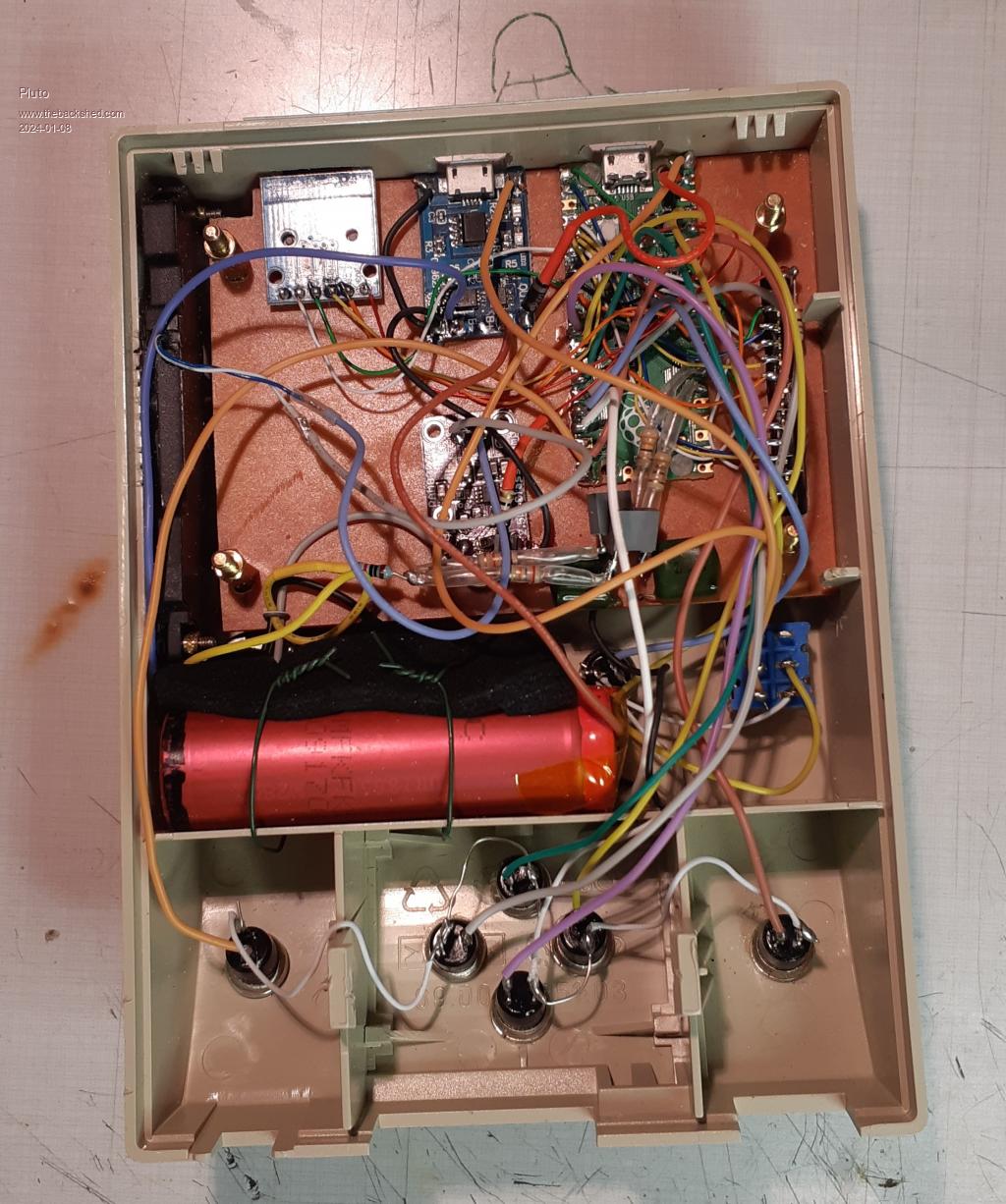

Tom,
it is not only a clone; it is more like a clown.
Enclosure from some old recycled (BOSCH) equipment. Can't remember what it contained.
LCD attached to a scrap PCB used as support for the various modules (SD, Charger, Pico and PAM8302 audio. Black thin box on left side is a recycled laptop speaker. Battery recycled from an old laptop.
Inside looks very much like a transistor radio from the sixties:
Believe it or not; It works!
The longer cables are soft silicone wires which enables the PCB to be removed from the box without need to desolder anything. Servicefriendly!
The only problem I had was with the (cheap) switches. Was corrected by with CRC Contact Protect.
PAM8302 sound is (fortunately) not too loud!

Even messier than the prototypes .
It's awesome, I love it.

I used to build stuff "dead bug" style. Beauties like this remind me of those times. :)
Interestingly shaped box. I wonder what it was? Possibly a mains cut-out or something?
Posted: 09:16pm 08 Jan 2024
and I thought my wiring was messy :)
