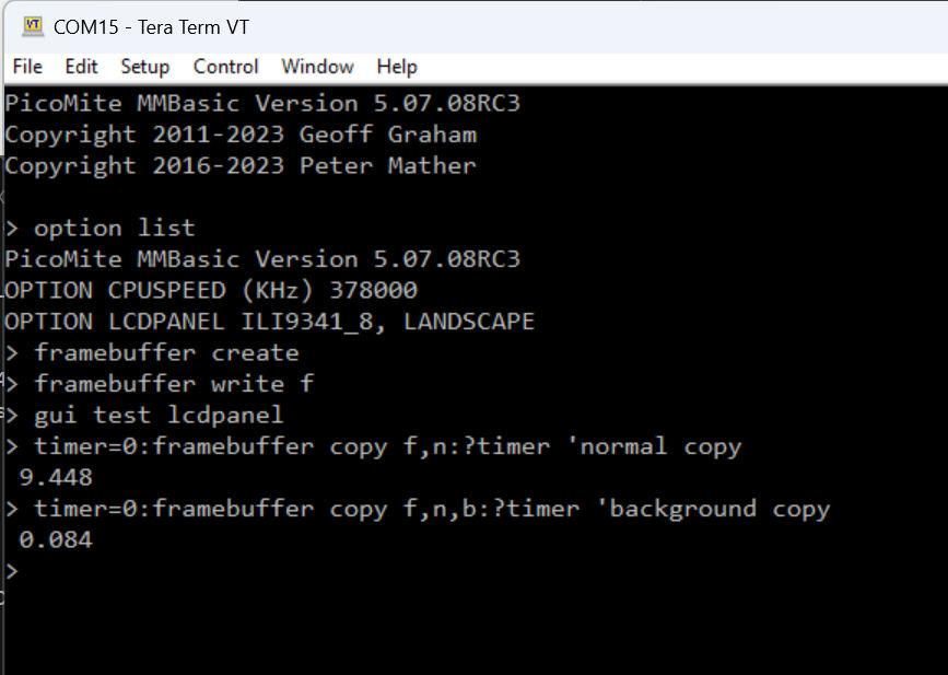

  Quote  There would then be no difference between VGA and LCD in terms of program speed.
Not the case. Framebuffer copy f,n on the VGA takes 0.6 mSec at 126MHz so max 1500FPS
Framebuffer copy to SPI still takes 90mSec so max 11FPS, it's just that you can do other processing while the copy is happening
That's what I meant with " in terms of program speed".
The Program continues while the 2nd CPU does the "Copy Job". So the Screen refresh is slower, but the Program not.

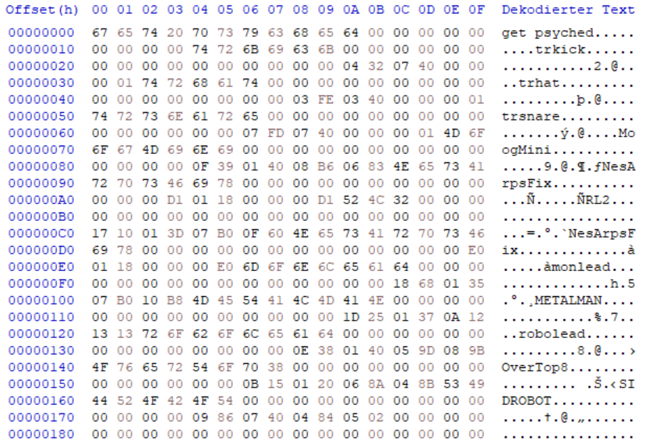

  matherp said
No. That is the whole point. The sound effect is coded on a specific channel (32 available) but is not included in the music schedule. PLAY MODSAMPLE triggers that channel alongside anything else playing
They are all on Github, but in an (for me) unknown Format.
Seem to be somehow like MOD but they are not MODFiles.
so I have to find a way to convert them(simply renaming them doesn' work   )

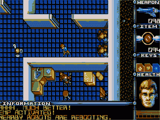

Posts: 6199
Posted: 07:06am 26 Sep 2023
From the PETROBOT.h (header file)

Posted: 08:08am 26 Sep 2023
Looks like a lot of work, but it's in the hands of professionals
I'll see later if I can get the sound files decrypted and reformat them to MOD if possible.
the decryption of the File Format should be hidden here.
Have Fun and good Luck
Mart!n

Posts: 12071
Posted: 08:47am 26 Sep 2023
This is more like it    This provides a proper platform for games (Tom!)
