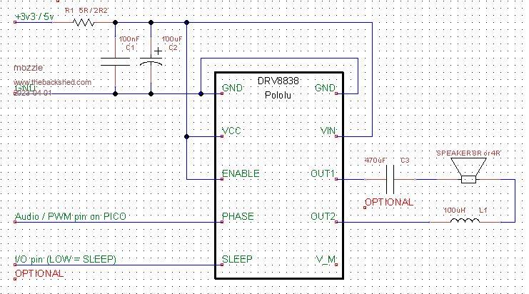

For driving A small 8R speaker from a Pico:
@Volhout
As suggested, the DRV8838 H bridge module is now hooked up and makes an excellent PWM buffer amp. Output is almost (-200mV) rail to rail into a 8R voicecoil (8R + 37uH) and is virtually silent at no signal and equivalent to the 3W PAM at full output.
Current draw is 50mA with a 100uH inductor in series with the speaker.
Circuit is Module + Supply decoupling + Speaker + (optional) Inductor
If designing anything with simple audio output this will be my choice.
Output is better than the emitter follower design but you are reliant on the supply of the module or getting the tiny package soldered, I like discrete solutions sometimes due to an oversupply of transistors etc here

mozzie
Joined: 15/06/2020
Posts: 472
Posted: 11:53am 01 Apr 2023
G'day All, madly attempting to stuff the worms back in to the can, alas I think the effort is in vain..
Fairly new here so apologies if offense has been caused or my efforts are seen as hijacking, I believe this thread is titled "PicoMite: driving a small speaker" and seeking filter and amp circuits for this purpose.
As Tom has stated he is open to options other than the PAM amplifier and the "H bridge" is just that, except amp then filter. However I am more than happy to start (or follow) a new thread on this if he thinks this is diverging too far from the original intent of the thread or causing confusion, however I still believe for the TomBoy application, it would be perfect.
Only downside is you have to buy it as a module due to the chip package
The circuit for those interested:
Current draw from Vsys on USB  (4V8) 30mA idle - 160mA active (200HZ sine @ 100%)
Current draw from Vsys on BATT (4V2) 26mA idle - 150mA active (200HZ sine @ 100%)
Current draw with SLEEP LOW = SFA (very low)
Volume control via software in sound function (or pot on A/D)
As its class "D" the speaker coil resistance and inductance in series with the 100uH inductor at 44KHZ  means the voice coil has around 130mW idle current, nothing to worry about.
Also almost no real 44khz from the speaker using an ultrasonic transducer as a microphone (and our cats aren't bothered by it either)
Happy to help either way.
Lyle.
Posted: 11:59am 01 Apr 2023
I'm thinking the 130mW is a better measure of tweeter survival than the transducer measurement (I guess a tweeter might fail to move adequately yet overheat, with rather more than 130mW).
Er, 130mW isn't current, it's power, dunno whether you meant 130mA?
Posts: 3417
Posted: 12:19pm 01 Apr 2023
It's about the same either way.
130mA^2 * 8R = 135mW
at 160mA it's 205mW - barely warm.
Edited 2023-04-01 22:32 by phil99
