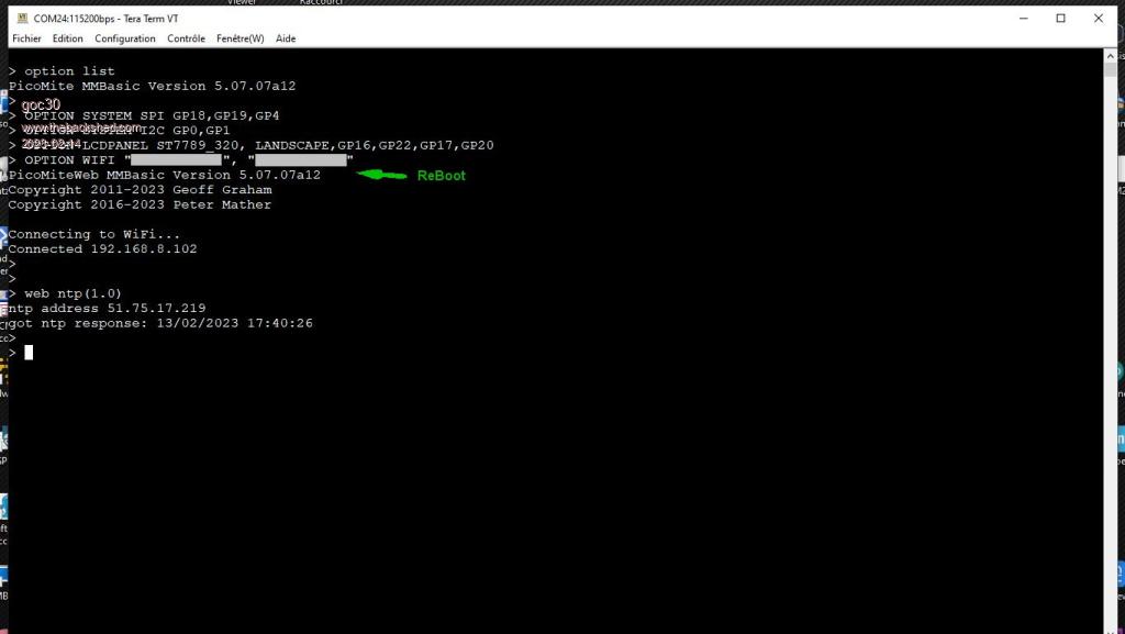

There is progress. I was able (finally) to enter my 3 minimum options "System" and lcdpanel without blocking the card.
However, after entering the WIFi option, I had to restart the pico (powet off/power on) because I couldn't do anything anymore.
After the restart, I have wifi.
A little more effort and the picoW under picomite will be almost as good as under Arduino

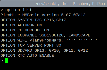

@matherp
Peter;
  matherp said
  Quote  Am I correct that the WIFI will not try and connect until you launch the console on the USB?
That's a bug caused by me being lazy and using printf with no USB connected. Will fix in next version
A12 works a charm now with no console needed, just power and go!
I also like how you masked the password on the WIFI option.
Thank you very much for the changes

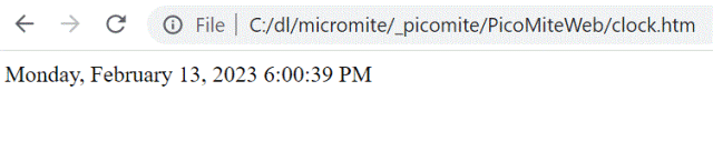

Without having any real understanding of how it might work with the PicoMiteWeb, I thought/hoped that javascript might work, since as I understand it, execution is on the PC side.
I have a little html file which presents Day of Week, Month, Day, Year, Time (with the time updated second by second). This works when I just put the local address of the file in a browser line: file:///C:/dl/micromite/_picomite/PicoMiteWeb/clock.htm
When I try to serve it from the PicoMiteWeb, I get a syntax error:
>run
ntp address 162.159.200.123
got ntp response: 13/02/2023 15:26:41
String is       GET / HTTP
sending page
[33] WEB transmit page ii%,"clock.htm"
Error : Expression syntax
Here's the HTML:
<html>
<div id="clockbox"></div>
<script type="text/javascript">
var tday=["Sunday","Monday","Tuesday","Wednesday","Thursday","Friday","Saturday"];
var tmonth=["January","February","March","April","May","June","July","August","September","October","November","December"];
function GetClock(){
var d=new Date();
var nday=d.getDay(),nmonth=d.getMonth(),ndate=d.getDate(),nyear=d.getFullYear();
var nhour=d.getHours(),nmin=d.getMinutes(),nsec=d.getSeconds(),ap;
if(nhour==0){ap=" AM";nhour=12;}
else if(nhour<12){ap=" AM";}
else if(nhour==12){ap=" PM";}
else if(nhour>12){ap=" PM";nhour-=12;}
if(nmin<=9) nmin="0"+nmin;
if(nsec<=9) nsec="0"+nsec;
var clocktext=""+tday[nday]+", "+tmonth[nmonth]+" "+ndate+", "+nyear+" "+nhour+":"+nmin+":"+nsec+ap+"";
document.getElementById('clockbox').innerHTML=clocktext;
GetClock();
setInterval(GetClock,1000);
</script>
<html>
Am I doing something wrong, and/or is there a way to get this to work on the PicoMiteWeb (the file is named "clock.htm")?

  Quote  Am I doing something wrong, and/or is there a way to get this to work on the PicoMiteWeb (the file is named "clock.htm")?
Hi, Lisby.
You'll need to put your javascript into a separate file eg "getclock.js" then add
<script src="getclock.js" type="text/javascript"></script>
to your HTML.
also, you'll need to add
ElseIf page$="getclock.js" Then
Print "Sending script"
WEB transmit file a%,"getclock.js","script/javascript"
into the TCPrequest subroutine.
The {} characters are being interpreted as tags for basic strings.
Edited 2023-02-14 10:58 by TheMonkeys

If you leave it in the HTML file, just double up on the opening curly brace and all will be well again.
function GetClock(){{
It just won't run correctly when you test it on your local PC if you access the file directly.

With the doubled "{{", I now get "Sending page", but in the browser, "This page cannot be found".
(I noticed that my html code ended with "<html>", not "</html>". I changed it, but no difference.)
> load "clock.html"
> list
<html>
VAR tday=["Sunday","Monday","Tuesday","Wednesday","Thursday","Friday","Saturday"];
VAR tmonth=["January","February","March","April","May","June","July","August","September","October","November
","December"];
Function GetClock(){{
VAR d=new Date();
VAR nday=d.getDay(),nmonth=d.getMonth(),ndate=d.getDate(),nyear=d.getFullYear();
VAR nhour=d.getHours(),nmin=d.getMinutes(),nsec=d.getSeconds(),ap;
If (nhour==0){ap=" AM";nhour=12;}
ElseIf (nhour<12){ap=" AM";}
ElseIf (nhour==12){ap=" PM";}
ElseIf (nhour>12){ap=" PM";nhour-=12;}
If (nmin<=9) nmin="0"+nmin;
If (nsec<=9) nsec="0"+nsec;
VAR clocktext=""+tday[nday]+", "+tmonth[nmonth]+" "+ndate+", "+nyear+" "+nhour+":"+nmin+":"+nsec+ap+"";
GetClock();
</script>
</html>
The .bas file:
> load "web.bas"
> list
 Dim buff%(512)
 WEB tcp interrupt TCPrequest
 WEB ntp -5
main:
'Sub poll
Sub TCPrequest
Local p%, t%, ii%, ss$
For ii%=1 To MM.Info(max connections)
  If Not MM.Info(TCP request ii%) Then Continue For
  LongString clear buff%()
  WEB tcp read ii%,buff%()
  p%=LInStr(buff%(),"GET")
  t%=LInStr(buff%(),"HTTP")
'   If LLen(buff%()) Then Print "_________________________________________________"
  If Not LLen(buff%()) Then Continue For
  ss$=""
  If (p%<>0) And  (t%<>0) And (t%>p%) Then
    ss$=LGetStr$(buff%(),p%,t%-p%+4)
    Print "String is ",ss$
  If Instr(ss$,"small") Then
    Print "sending picture"
    WEB Transmit FILE ii%,"small.jpg","image/jpeg"
  ElseIf Instr(ss$,"favicon") Then
    Print "sending icon"
    WEB Transmit FILE ii%,"favicon.ico","image/vnd.microsoft.icon"
  ElseIf Instr(ss$,"HTTP") Then
    Print "sending page"
    WEB transmit page ii%,"clock.html"
Next ii%
Posted: 02:44am 14 Feb 2023
@TheMonkeys -- Thanks for your suggestion. I tried it, and got closer.
I'm getting a response to the browser--but the page is blank. If I "view source", I see the html code but not the js code. The PicoMiteWeb says it is sending the js code file.
It's too late in the day here for me to be able to make sense of what I may be doing wrong. I'll try again tomorrow.
Posted: 03:44am 14 Feb 2023
@lixby
You need to replace all instances of a single { with {{.
Any html file a single { indicates the start of a variable name. The double {{ is MMBasic's signal to send a single { and not substitute a variable value.
clock.html
<html>
","December"];
VAR d=new Date();
If (nhour==0){{ap=" AM";nhour=12;}
ElseIf (nhour<12){{ap=" AM";}
ElseIf (nhour==12){{ap=" PM";}
ElseIf (nhour>12){{ap=" PM";nhour-=12;}
GetClock();
</script>
</html>

else if has turned into ElseIf, function into Function.
Anyway, fixed these up and the clock now runs via the web page :)

Reformatted post from @TassyJim
<html>
var d=new Date();
if(nhour==0){{ap=" AM";nhour=12;}
else if(nhour<12){{ap=" AM";}
else if(nhour==12){{ap=" PM";}
else if(nhour>12){{ap=" PM";nhour-=12;}
GetClock();
</script>
</html>
Tony
Posted: 06:10am 14 Feb 2023
  morgs67 said  Reformatted post from @TassyJim
Tony
Thank you for that.
My java-script knowledge is zero. I just knew the { needed tweaking for the web server.
