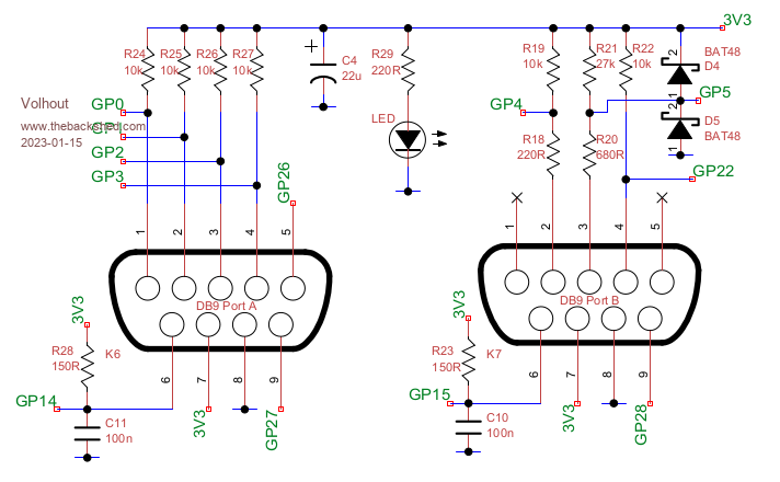

Appendix B: planning for PIO use
When we make a new design around the picomite, and envision to use PIO, the knwoledge we have now can be used to make compact and efficient code. Peter and Geoff have created a MMBasic and have created so many pin related features that we may have become lazy in assigning pins. But for some, like I2C/SPI we still need to use specific pins.
PIO is much more forgiving, but most efficient PIO code relies on pins that are close together. In our training we used GP0..GP5 (a set of GPIO lines that is free tu use in the VGA picomite). But when your starting point is the normal picomite, you may be attracted to choose different. Below example shows the consequences.
Disclaimer: This example is based on a design that was not intended to use PIO, potential use of PIO was evaluated later, and proved to be complex. With the knowledge you have build up, you can avoid complexities like this.
The example:
GAMEpicoVGA platform created by Tom (thwill) and Mick (Mixtel90). This platform was created with the intend to use the VGA picomite as a gaming platform. The major change was the addition of 1 or 2 game interfaces for controllers. And make these interfaces as versatile as possible (compatible with analog joystick, NES controllers, Atari Joysticks etc...)
Figuring out all these different interfaces was a major undertaking, and both Mick and Tom deserve credit for that. The VGA picomite platform was adapted in following way:
The analog joystick support (port B) uses the A/D convertors on GP26,27,28, but these can also duplicate as digital pins. The AtARI joysticks have switches, and individual switches can be read from MMBasic (interrupt even) easily. The NES controllers that are also target to be supported are serial (SPI) devices. The NES controller is a CD4021 (chapter 9), the SNES controller is a 16 bit version (2xCD4021), or similar.
PIO could be of great help in doing the serial interface to the (S)NES controller. We could easily port the code from chapter 9 for port A and port B.... The code we made was configured in the PIO configuration. 1 piece of code, 2 different configurations, and we have 2 NES controller interfaces. Easy peasy... No Lets look at the connectors.
The NES game controllers use a 9 pin sub-D connector with pinout:
pin 2 = DATA
pin 3 = LOAD
pin 4 = CLOCK
pin 6 = Vcc
pin 8 = GND
For the PIO configuration this will result in:
PORTA:
GP1 = DATA ------- IN group
GP2 = LOAD ------- SET group
GP3 = CLOCK ------ SET group
PORTB:
GP4 = DATA -------- IN group
GP5 = LOAD -------- SEt group
GP22 = CLOCK <------oops does not fit int he SET group, (5 pins max).
Looking at the pinout, PORTA is a simple re-configuration of the code we used in chapter 9. But PORT B can not. The clock line (GP22) cannot be combined with the SET group that GP5 is in. In the ZIP provided later you can see a solution for CD4021 using SIDE SET. But for the SIDE SET, also a group size of maximum 5 (sacrificing all DELAY fields) is possible.
A solution was found in using both SET and SIDE SET groups in a mix. control LOAD from the SET group, and CLOCK from the SIDE SET group.
PORTA:
GP3 = CLOCK ------ SIDE SET group
PORTB:
GP22 = CLOCK <------SIDE SET group
Below example shows the solution code. The code is well documented, so it should be no problem to understand what the code does. The only complexity is that the SIDE SET pin must be made output. For port B that cannot be done with a SET command (can do GP5,6,7,8,9, but not 22). We have discussed a way to do it in chapter 10: Use the OSR (output shift register) to shift a logic "1" into the PINCTRL register. This "trick" can only work when GP22 is part of the OUT group. So despite that we are not using serial shift out, we have to configure the OUT group.
Note LOAD is called "latch" in below program.
'PIONES16 - PIO SPI for SNES controller
'VGApicomiteGAME board revision 1.4
'Shrink version (both stamemachines run same code)
'-------------------------------- IO pin configuration -------------------------
'pin asignment K8/sm0 K7/sm1
'data (in)     gp1    gp4
'latch (out)   gp2    gp5
'clk (out)     gp3    gp22
'reserve pins for PIO1
SetPin gp1,pio1:SetPin gp2,pio1:SetPin gp3,pio1  'sm0
SetPin gp4,pio1:SetPin gp5,pio1:SetPin gp22,pio1 'sm1
'power the 2 ports K8 and K7 if needed
SetPin gp14,dout:Pin(gp14)=1
SetPin gp15,dout:Pin(gp15)=1
'--------------------------------- PIO configuration --------------------------
'PIO1 execute frequency
f=200000   '200kHz to achieve same responsiveness as 100kHz 8 bit controller
'note: the PIO program for both PIO's is the same, only the IO definition
'in the pinctrl register is different. The statemachines actually run same code
'pio config PIO1 sm0
s0=PIO(shiftctrl 0,0,0,0,0,1)         'default with IN shift left, OUT shift right
p0=Pio(pinctrl 1,1,1,GP1,GP3,GP2,GP3)  'GP1=IN base GP2=SET GP3=OUT/SIDESET
'pio config PIO1 sm1
s1=PIO(shiftctrl 0,0,0,0,0,1)          'default with IN shift left, OUT shift right
p1=Pio(pinctrl 1,1,1,GP4,GP22,GP5,GP22) 'GP4=IN base, GP5=SET GP22=OUT/SIDESET
'------------------------------ PIO program (comment) -------------------------
'pio1 sm0 program, identical code for sm0 and sm1, clock is side set pin
'adr/instr/comment
'0 E081 'set pindir latch, out     [side 0]
'1 E000 'set latch low             [side 0]
'2 A0EB 'MOV null inverted to OSR  [side 0]
'3 6081 'OUT 1 bit OSR to pindirs  [side 0] set clock output
'4 E001 'latch high                [side 0] latch pulse
'5 E000 'latch low                 [side 0]
'6 E02F 'load X with value 15      [side 0]  <---------SNES = 15, NES = 7
'7 A0C3 'mov NULL to ISR           [side 0]
'8 4001 'shift 1 bit data in ISR   [side 0]
'9 1048 'JMP X-- to &h8            [side 1] this is the clock pulse
'A 8000 'push ISR                  [side 0] 16 bits to fifo
'B 0004 'jmp to &h4                [side 0] next cycle
'&h0C....&h1F not used
'------------------------- END PIO program (comment) --------------------------
'pio1 program in data statements
Dim a%(7)=(&h6081A0EBE000E081,&hA0C3E02FE000E001,&h0004800010484001,0,0,0,0,0)
'program and start the PIO1 state machines
PIO program 1,a%()      'program PIO1
PIO init machine 1,0,f,p0,,s0,0       'init sm0 from address &h00
PIO init machine 1,1,f,p1,,s1,0       'init sm1 from address &h00 (same code)
PIO start 1,0                         'start PIO1 sm0
PIO start 1,1                         'start PIO1 sm1
'------------------------------ MAIN level -----------------------------------
Print "running"
dim h%(4)
'read the FIFO's that contain the NES controller keys
PIO read 1,0,5,h%() 'read from FIFO sm0
Print Hex$(65535-h%(4)), 'print value
PIO read 1,1,5,h%() 'read from FIFO sm1
Print Hex$(65535-h%(4)) 'print value
Pause 100
Loop 'While Inkey$=""
End
Note that this version was created 1 year ago, and could be optimized more with the knowledge we have today (using .wrap).
But the code would have been so much simpler when the PORTA and PORTB pins where connected differently.
And that is the motto for this appendix. Plan PIO use when creating a circuit diagram.
Edited 2023-01-15 20:32 by Volhout
