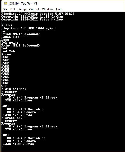

PicoMite V5.07.05RC8
Corrects reporting of MM.HRES and MM.VRES by OPTION LIST when a user driver is loaded
Fixes bug in PLAY TONE n. m. d, interrupt which caused the interrupt not to fire
Fixes bug in ERASE command when erasing arrays
Fixes bug in audio commands executed at the command line - introduced in previous RC
Implements mm.info$(sound) to report status of the audio channel
Implements ON PS2 interrupt. This triggers an interrupt whenever the PicoMite sees a message from the PS2 interface.
Use MM.info(PS2) to report the raw message received. This allows the programmer to trap both keypress and release.
See https://wiki.osdev.org/PS/2_Keyboard for the scan codes (Set 2).
Resets default fonts when a new program is loaded or the NEW command is executed.
