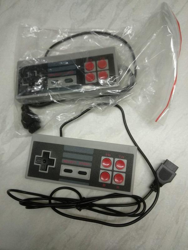

Posted: 02:50pm 14 Apr 2022
Good afternoon Mick,
My parts continue to accumulate, including the controllers. Before I put a couple in the post for you I wanted to check you actually want them?
Note I've had one open and it looks the part - as far as you can tell when all the logic is just a resin blob - but I haven't tested them.
Posts: 9253
Posted: 03:22pm 14 Apr 2022
I'd love one, thanks Tom. I'm not sure about two? Could I use two of them? Hmmm...
They certainly do look the part. :)
Don't they have extra buttons? They may be interesting to read.
Posted: 03:29pm 14 Apr 2022
  Mixtel90 said  I'd love one, thanks Tom. I'm not sure about two? Could I use two of them? Hmmm...
I'll stick a pair in the post when I get a chance, they were cheap as chips.
The two extra red buttons are the auto/turbo-fire buttons and are connected via an oscillator in the resin blob. They send the same signals as the A or B buttons would if pressed repeatedly.
Posts: 9253
Posted: 03:34pm 14 Apr 2022
Excellent, thanks. :)
