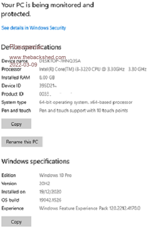

I wonder what dll  are needed to runing mmb4w?
I testet up to 30 win pc in the last time without problems but
Frank N Furter shows a Problem. So iam curious , can you sort it out ?
Plasma
Posts: 12059
Posted: 03:39pm 07 Mar 2022
winmm..dll
user32.dll
gdi32.dll
opengl32.dll
The problem one based on his report is winmm.dll. All the others were needed to run versions he said worked

Can anyone send me these DLL's?
THANKS!!!
Frank

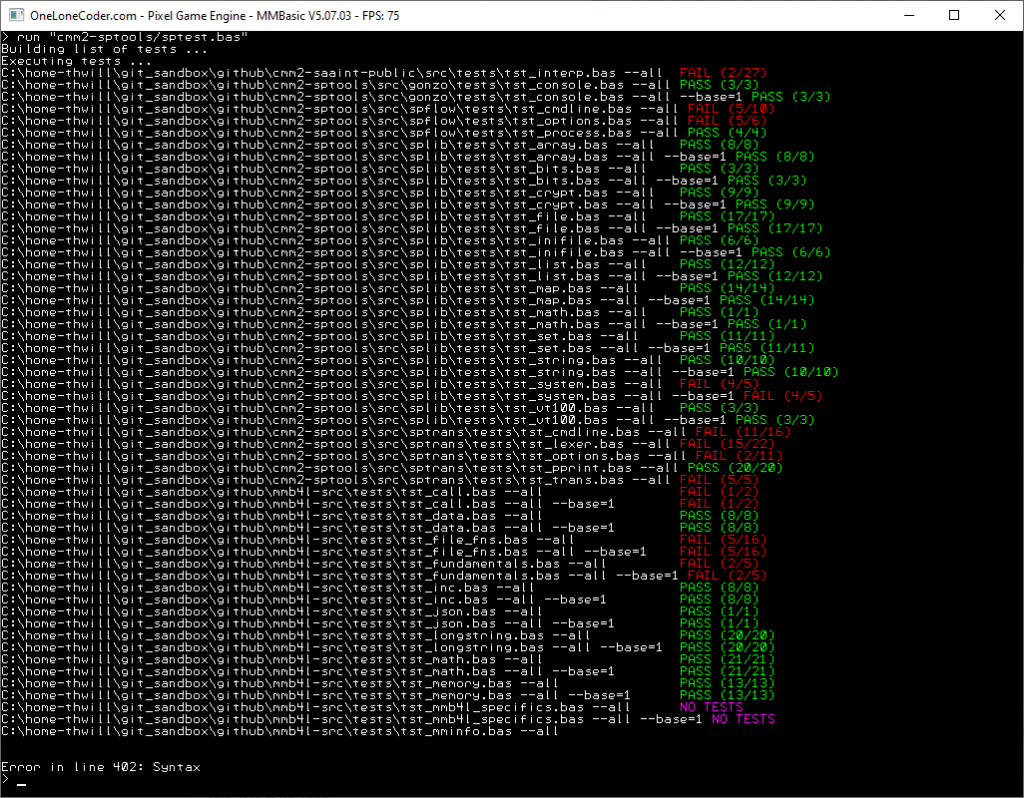

Starting to look pretty good with b4:
Notes:
1. I'm currently focusing on getting them all to run without crapping out ... which is what tst_mminfo is currently doing due to no OPTION SEARCH PATH being implemented.
2. Some of the FAILures are almost certainly false positives.
3. This is NOT a comprehensive set of unit-tests.
Two for today before I do some "real work":
1. Is OPTION SEARCH PATH not supported in MMB4W ? Will it be ?
2. Try this:
> files "a\b\c"
Not found: C:\home-thwill\git_sandbox\github\a\b\\c
Note the double \\ before c.
Edited 2022-03-08 20:18 by thwill

Joined: 31/01/2019
Posts: 620
Posted: 03:31pm 08 Mar 2022
@Frank n.Furter
dll.zip
my win 10 64 bit dll files / from system32 folder
gtx
Edited 2022-03-09 01:32 by Plasmamac
Plasma

  Plasmamac said  @Frank n.Furter
dll.zip
gtx
MMBasic for Widdows is a 32-bit application.
Michal
Frank N. Furter
Joined: 28/05/2012
Posts: 1156
Posted: 04:24pm 08 Mar 2022
@Plasmamac:
Thank you very much - I copied your files to my MMBasic folder - unfortunately no change...
Frank
Posts: 12059
Posted: 04:26pm 08 Mar 2022
  Quote  I copied your files to my MMBasic folder
You need to copy them to Windows/system32
What CPU do you have?
Edited 2022-03-09 02:31 by matherp
Michal
Joined: 02/02/2022
Location: Poland
Posts: 125
Posted: 05:24pm 08 Mar 2022
The 32-bit libraries(in Windows 64bit) are located in Windows\SysWOW64.
Michal
Edited 2022-03-09 03:26 by Michal

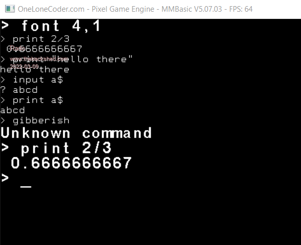

Just got some time to play with this (03.b5), and it seems that there's something with fonts: in command line, as soon as I enter something invalid the font reverses to default:
