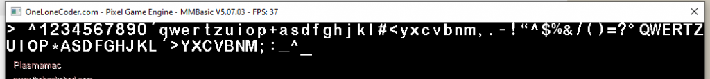

andreas
Joined: 07/12/2020
Posts: 226
Posted: 06:26pm 31 Jan 2022
Hello,
in pa9 and DE keyboard, I cant type a question mark "?", and no "<" and ">". There is no "\" i.e. for integer division and path assignments  in option default path C:\...
"+" is "'" and "#" is "^" and "-" is "#" and no "[" and "]"

twofingers
Joined: 02/06/2014
Posts: 1784
Posted: 06:45pm 31 Jan 2022
Hi Andreas,
can you please create a list like that:
https://www.thebackshed.com/forum/ViewTopic.php?FID=16&TID=14518#181313
Best regards
Michael

andreas
Joined: 07/12/2020
Posts: 226
Posted: 06:51pm 31 Jan 2022
@twofingers  I thought I did it already? There was a picture containig a "wanted" and a "currently" code generated with pa3.
wanted has meant the code it should be in german and "currently" was what Peters pa3 generated.
https://www.thebackshed.com/forum/ViewTopic.php?FID=16&TID=14518#181313#181284
-andreas

andreas
Joined: 07/12/2020
Posts: 226
Posted: 07:02pm 31 Jan 2022
can you specify a path in option default path ?
I can't because in pa9 is no \
I'm using an IBM Model "m" and a perixx keyboard
Im running wine under debian linux to start MMBasic.exe
hmm... I could try to start MMBasic in a virtualbox Windows 10 or 11 - have both here..
-andreas

twofingers
Joined: 02/06/2014
Posts: 1784
Posted: 07:20pm 31 Jan 2022
@Andreas
  andreas said  @twofingers  I thought I did it already? There was a picture containig a "wanted" and a "currently" code generated with pa3.
...-andreas
Yes, you did it! (I did not realize that. Sorry! )
I don't understand why your table is different from mine.
I would expect them to be identical.
For UK layout I get the backslash with the key 92 (^) left of the "1".

andreas
Joined: 07/12/2020
Posts: 226
Posted: 08:11pm 31 Jan 2022
I tested pa9 with a nativ Windows 10 Fujitsu Notebook, german keyboard layout: works good!
I could not start MMBasic within VirtualBox 6.1 under Windows 7 & Windows 10. - it shows a white window.
Under wine/linux pa5 seems to be the best for me. I put some additional labels on the keys ;-)
So wine seems to have some hidden layer which does not fit - when I open the command windows CMD under wine and type any key, it is correct according to my keyboard but not together with MMBasic :-/
But this is my problem, not yours
-andreas
