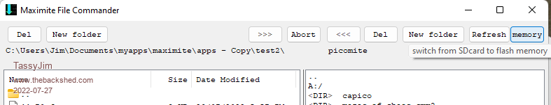

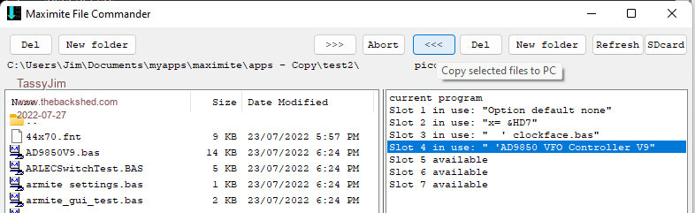

Posted: 07:00am 27 Jul 2022
I came across a nasty bug that could cause MMEdit to lock up when loading certain files.
I have posted a bug fixed version for Windows and Linux but not RPi yet.
I have been working on the File Manager and have made good progress.

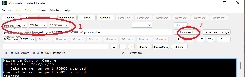

Step 1. select the device type (picomite and picomiteVGA are treated the same).
select com port and baud rate. If your picomite is using the on-board USB, the baud rate doesn't matter.
Step 2. Connect to your device.
Select File Manager from the Mode menu.
The first time it is run there is a very long wait. The PC side wants to read all the directory structure. It will remember the last path so shouldn't be an issue next start unless you had it pointing to a nonexistent folder.
To transfer files, select one or more files then click on " >>>" to transfer to the 'mite and "<<<" to transfer from the mite.
The abort button lets you interrupt a file transfer.
With the picomites, you can also select "Memory" to list the programs saved in flash. Click on SDcard to get back to SD storage.
When working with the flash, it is one file at a time. If you have multiple files selected, only the first will be transferred.
To copy a file to the picomite, it has to be loaded into program memory first before being saved to a flash slot.
This means that any existing program in current program memory is overwritten.
To transfer to a flash slot or current program, select the file on the PC and click on ">>>". You will be prompted to select the destination on the picomite.
You can overwrite an existing saved slot without any warning so think first!
Transferring from the picomite is direct from the flash to the PC. The current program is safe. Select the desired slot or current program and "<<<".
You will be prompted for a filename.
Transfers to and from the SDcard will use XMODEM while transfers to and from flash use AUTOSAVE and LIST
I will work on the slow initial File Manager start.
