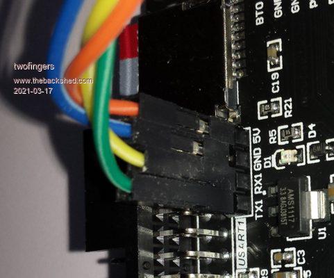

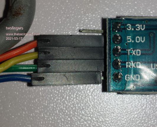

Something strange about the firmware download/programming (Board V33):
I had to use the serial (TX-RX, RX-TX) port as the USB seems to stop working in bootloader mode. When I used the normal jumper settings, I was unable to connect to the CubeProgrammer.
Then I tried without the BT1 jumper and ... was successful.
Michael

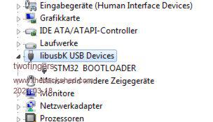

It seems that Zadig (https://zadig.akeo.ie/) solved my connection issue with Win7, the STM32F407VET6 (V33) and the CubeProgrammer. I found it after reading this thread: https://community.st.com/s/question/0D50X00009XkXagSAF/dfu-usage-with-stm32cbeprogrammer
BT0 jumper only! That's weird because it worked twice with BT0 + BT1 plugged in.

Also had problem with Windows 10 finding V33 board bootloader. Moved USB plug from usb3 port to usb2 port. Problem gone.

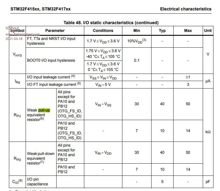

Does this chip have more than one size pullup option. I would have thought the usual 100k would be too high for reliable communication at the high data rates of SD.
Posts: 6209
Posted: 12:18pm 18 Mar 2021
Hi Phil99,
The weak pullup inside the STM32F407 is 40kohm.
The suggested external resistive pullup is 47k ohm as I recall.
Therefore the internal pullup is even stronger than the suggested external resistor.
Posts: 12084
Posted: 12:23pm 18 Mar 2021
I didn't originally enable the internal pullups as the board is supposed to have external. These are really too strong (10k) so with the internal enabled as well we are now on 8K. Assuming it works for boards with the pullups I'll leave the internal in place.

The resistors I added to my V33 were 8k2 and all the SD cards I have worked fine. That is very close to the 10k//40k combination. The usual range for fast busses is 2k to 20k so the 47k recommendation is higher than I expected. The very short distance from chip to socket might be the reason. (could it be a typo? 4.7k perhaps?)
To Andrew_G,
The version that fixed my V33 is:- 2021-03-17_181307_ArmmiteF407.zip
at:- https://www.thebackshed.com/forum/uploads/matherp/2021-03-17_181307_ArmmiteF407.zip
If that doesn't fix it then pullups, (say 22k as a compromise between recommended value and what we know works) on SD socket pads 1,2,3,7,8 but not 5 (CLK) should.
It's tricky but you can stand them on end then put a bridge wire across the top of them, leading to the center pin of the 3.3V regulator. It took me more than an hour to get it right with no bridges between pads.
Posted: 06:22am 19 Mar 2021
  phil99 said  To Peter,
The SD (brief) specs talk about 10k to 100k in some places and 50k in others so 47k sounds right to me.
