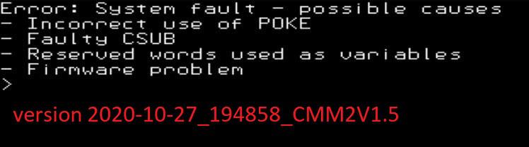

@Peter ...
Not sure if this belongs in the v5.05.06RC5 thread or here.
I seem to have found a bug in SELECT CASE or I am completely misreading the Manual.
However I try to use SELECT CASE in my program I get
This is the source code that produces the error:
' SELECT CASE Bug v5.05.06B15 and v5.05.06RC6 and EXP VERSION 2020-10-27_194858_CMM2V1.5
'Recommended Program Practice

This is a little self contained test program to show the error I seem to have found, with commented sections to show what I tried.
I chopped this out of the program I am working on and made it selfcontained for easier testing (same code posted above).
The firmware versions I tried this on were:
Hopefully this is just me misunderstanding the instructions, or a simple bug fix.

Posts: 12086
Posted: 02:46pm 27 Oct 2020
  Quote  Not sure if this belongs in the v5.05.06RC5 thread or here.
This appears to be an MMbasic bug that is in all versions, at least on the CMM2. I've contacted Geoff about it.
In 5.05.05 the system just locks up and ctrl-C doesn't recover it. In 5.05.06 I've implemented a hardware watchdog so you get the watchdog timeout error.
The issue seems to be in the use of an array element in the select case. The workaround is to copy the array element to a simple variable for the select case
t$=M$(mR%)
  SELECT CASE t$
Edited 2020-10-28 01:22 by matherp

  matherp said  The issue seems to be in the use of an array element in the select case. The workaround is to copy the array element to a simple variable for the select case
t$=M$(mR%)
  SELECT CASE t$
@Peter ...
Many thanks for the clarification, workaround, and for replying so fast.
This was the first time I had used SELECT CASE on the CMM2 and it had me completely foxed.
Your help is as always, Greatly Appreciated

Posts: 12086
Posted: 04:04pm 27 Oct 2020
  Quote  Is it this what you wanted to code:
That also works without crashing but if you can use SELECT A$ then logically you should be able to use
SELECT ARRAY$(I%) . In both cases the match won't happen if the CASE string and the SELECT string aren't the same. So the code was probably functionally incorrect but shouldn't have crashed.
