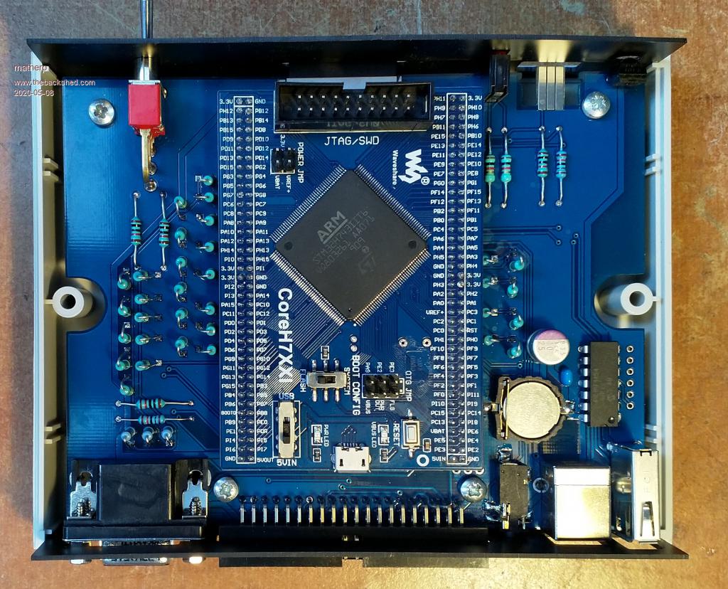

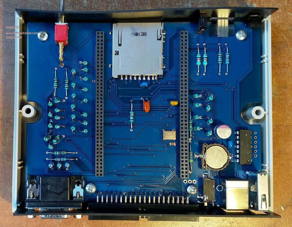

More pics
These pictures show the V2.1 motherboard as included in the construction pack. Unfortunately due to operator error (me being an idiot) there is no top silkscreening on my PCB. The gerbers in the construction pack are complete and correct. The pictures show the 8MHz crystal on the Waveshare PCB removed and the optional 8MHz oscillator fitted to the motherboard. This was done purely for test purposes and is normally not required.
Note how the 10uF tantalum capacitor below the SDcard socket is laid on its side. This is explained in the construction pack and is needed to provide clearance from the Waveshare PCB.

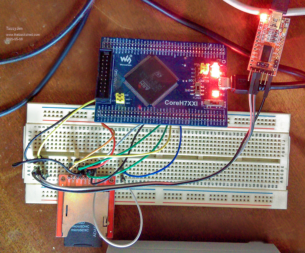

Are you (or others) able to supply more details on how you actually connect a 'Mite to a network using the modules listed above.
I noticed TassieJim had an ethernet cable connected to his CMM-2 setup.
Brian
Well spotted finding the Ethernet cable in my photo.
It didn't show the other end which ha s a GPS connected. No network involved, just re-purposing a cable.
I do have a CMM2 (bare minimum) connected to the net for testing. As usual, I use ser2net on a RPi as the interface.
tassyjim.ddns.net port 44002
I can't guarantee that it will always be there and it only allows one connection at a time so may be busy.

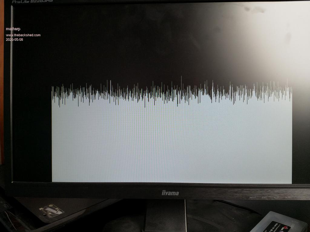

For interest the attached is a pictorial demonstration of the random number generation. The program takes 5 seconds to run (240,000 random numbers binned and plotted)
cls
dim a%(799)
for i%=1 to 800*300
 j%=rnd(799)
 a%(j%)=a%(j%)+1
next i%
for i%=0 to 799
 line i%,599-a%(i%),i%,599
next i%
do
loop
