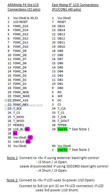

I believe you do have the SPI data lines reversed. I have just connected up an East Rising 9" LCD to my ARMMite F4. Below is the list of connections that I used between the LCD connector on the F4 module and the LCD screen connector.
As shown I have ARMmite LCD connector pin 25 (T_MOSI) connected to ER LCD pin 35 (T_DIN - this would be pin 22 on a standard SSD1963 LCD connector) and ARMmite LCD connector pin 26 (T_MISO) connected to ER LCD pin 36 (T_DOUT - this would be pin 26 on a standard SSD1963 LCD connector).
This arrangement is working properly, I have been able to perform the GUI CALIBRATE without any issues and GUI TEST TOUCH works ok as does the display on the LCD.
Hope this info helps.

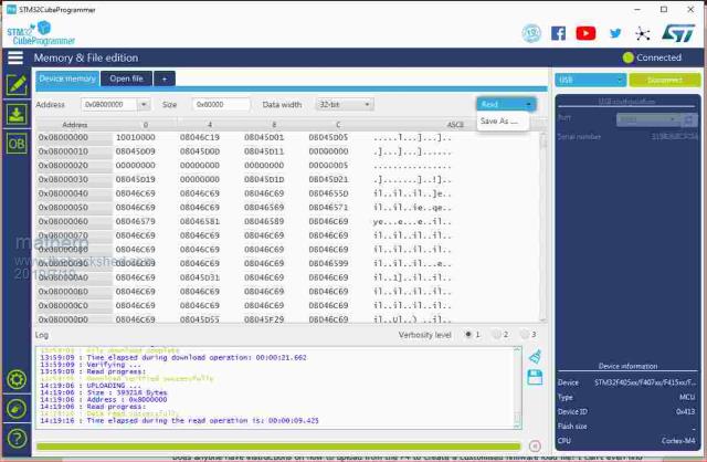

  crez said   Has anyone used the STM CubeProgrammer to upload from an F4? It is a bit unclear to me what memory range you need to faithfully copy with the basic program intact.
  matherp said
  Quote  It is a bit unclear to me what memory range you need to faithfully copy with the basic program intact.
All of it - sectors 0 to 11 inclusive
Does anyone have instructions on how to upload from the F4 to create a customised firmware load file? I can't even find where to start an upload from in the STM32 CubeProgrammer.
Phil.

  Quote  Does anyone have instructions on how to upload from the F4 to create a customised firmware load file?

@matherp - Thanks, I didn't see the "Save As..." option in the Read drop down. Unfortunately the image is a little blurred - can you please confirm the Address value is 0x08000000 and the Size is 0x6000?
Thanks,

Posted: 12:49pm 19 Jul 2019
  Quote  can you please confirm the Address value is 0x08000000 and the Size is 0x6000?
0x60000 not 0x6000

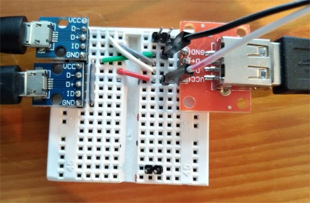

I've been unable to get the 7" SSD1963 LCD to respond on the F4. With the new software (5.05.08) and just the usb connection, I have no response to GUI CALIBRATE.
Here's the power arrangement I cobbled together to try to supply more:
The micro USB breakout adapter on the upper left (plugged into a laptop USB port) has power not connected, D+, D-, and GND connected to the adapter on the right, which plugs into the F4 USB connector.
The micro USB breakout adapter on the lower left is plugged into a power plug which provides up to 2.1A. It has successfully powered r-pi-zws. The white and black dupont wires on the breadboard are plugged into 5V and 0V respectively on the F4. 5V and 0V on the F4 are connected to 5V and 0V on the LCD adapter. For BL, 5V is jumpered.
This also gives me no response to GUI CALIBRATE. A current sensor on the power plug only shows .134A. I would expect something in excess of .500A since on the H7, this LCD draws .785A, .295A with the LCD disconnected (but with the H7 adapter on).

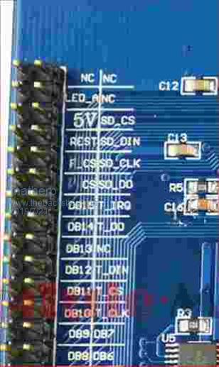

  Quote  Any thoughts about what I should try next?
Try bridging LED_A to the pin next to it labelled 5V on the adapter

Posted: 01:24pm 21 Jul 2019
Bingo! Thanks.
On first power-up, I got a current draw of .555A (good news)--but many colors on the screen. I'd gotten that before with the 4.3" LCD, and had found that RESET would fix it (maybe several times with different screen patterns)--and it did for the 7" with one RESET press.
Still no response to GUI CALIBRATE. But I fiddled some more, downloaded my program again, RESET several times, and then, with no wiring changes, GUI CALIBRATE worked, as did GUI TEST TOUCH and CLS, and my program.
So thanks very much. (FYI doesn't work with this particular 7" LCD when the F4 is just plugged straight into a USB port, though the current draw jumps to .443A.)
