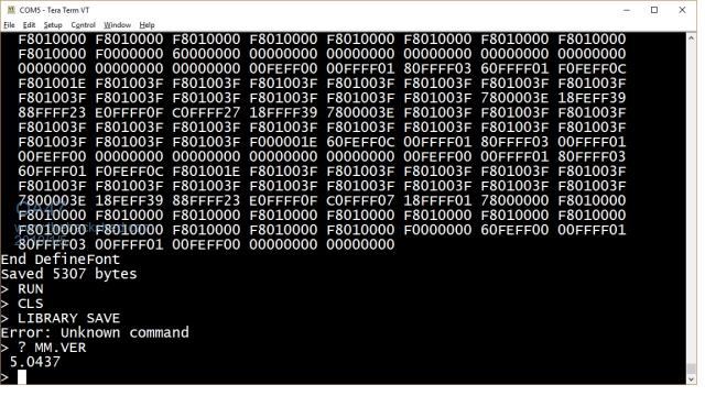

Posted: 12:51am 05 Jan 2019
Should I be able to save embedded fonts into the library area?
Not sure which commands are supported by the L4.
OA47

Posted: 01:08am 05 Jan 2019
FRom Page one:
  Quote  Missing:
all drawing, font and TFT capability
obsolete commands and functions as per MM2 manual
RANDOMIZE command, STM32 has hardware random number generator so not needed
LIBRARY command
Added:
DISTANCE command as per earlier versions of MM2
DHT22 command as per earlier versions of MM2
LONGSTRING commands and functions as per MMX/ARMMITE H7
WS2812 command as per MMX/ARMMITE H7
DAC command as per ARMMITE H7
DAY$ function as per ARMMITE H7
SPI2 commands and functions as per MM+/MMX/ARMMITE H7
Different:
TIME$ command sets the value from the RTC
TIME$ function returns the value in the RTC
DATE$ command sets the value from the RTC
DATE$ function returns the value in the RTC
MM.DEVICE$ returns "ARMMITE L4"
Edited by palcal 2019-01-06
OA47
Joined: 11/04/2012
Posts: 1056
Posted: 01:37am 05 Jan 2019
Thanks Palcal, I did read through that description this morning but missed the "LIBRARY command" bit at the end. I was a little bit confused when Peter posted his 7 segment clock code for the e-Paper display in an earlier post and used font 8 without it in his program code.

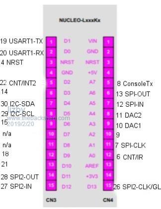

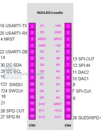

Posted: 05:26pm 19 Feb 2019
I've looked through this and other Armmite L4 threads, and while I may well have missed it, I didn't note anything which correlated the mmbasic pins to the text in the first post to the NUCLEO-L432KC (other than by comparing the D# and A# designations). This is my first pass at producing an image:
I have a number of questions.
Which are console RX & TX?
What is A7?
What are pin 23 SWDIO and pin 24 SWCLK? Are they rightly assigned to D7 & D8?
Are there errors or assigned usage for other pins?
Are there count pins?
Posts: 12084
Posted: 07:47pm 19 Feb 2019
  Quote  Which are console RX & TX?
PA2 is console TX (broken out as A7)
PA15 is console RX (not broken out on Nucleo)
  Quote  What are pin 23 SWDIO and pin 24 SWCLK? Are they rightly assigned to D7 & D8?
No, these pins are not broken out on the Nucleo
D7 and D8 are the 32KHz xtal pins so not usable
The Nucleo manual is the source for the pin allocation of D0 to 12 and A0 to 7
