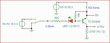

With the Micromite pin High the transistor will not conduct, the diode is off there is no current drawn the module is not powered
When the pin goes low the transistor conducts, the led lights, the HC-12 (or GPS) module gets power and works fine
  bigmik said   Hi Lew,
I hate being the Harbinger of DOOM
But..... I really do not understand that circuit at all, the way I see it the Emitter-Base junction will work as a diode and effectively be permanently supplying power to the LED/load.. Unless someone can show me the error behind my thinking and explain how that circuit works...
I have a simple Idea I will post in a future message..
I am not entirely dismissing that circuit as I honestly cannot understand how it would work and my transistor theory is rusty at best.
  lew247 said
Due to problems with the switching of the transistor I've had to modify the circuit
I'm informed this should work perfectly now
Edited by lew247 2016-03-26

The way I read the circuit above is that with the MM pin either high or high impedance, the PNP transistor will have it's base held to the emitter voltage by the resistor thus biasing it off (negligible current). When the MM pin goes low, the PNP transistor is biased on and the collector voltage will rise up to near Vcc (less the collector-emitter voltage) providing power for the device. LED should also light. Should work I think.
Cheers,
Doug.
Edit: The 10K base emitter resistor seems a bit high only allowing .5mA to turn on the LED - will depend on LED if this is enough.Edited by panky 2016-03-27

  lew247 said   With the Micromite pin High the transistor will not conduct, the diode is off there is no current drawn the module is not powered
Not quite correct. The 3.3 v from the uC is not enough to stop conduction.
If the PNP is fed from 3.3 volts as well, 3.3 volts out of the uC WILL stop conduction.
Fortunately, there is another way to stop conduction while retaining the 3.3 volt/5 volt split supply voltage setup. That's using not a high out of of the uC, but a floating pin (pin input mode).
So uC active low to switch load on, input mode (floating) to switch load off.
This has all been hashed out before in previous messages and this is the same basic circuit I proposed to Lew about 3 weeks in PMs, and about 2 weeks ago in public postings. So at this point we're beginning to go around in circles.
  Quote  When the pin goes low the transistor conducts, the led lights, the HC-12 (or GPS) module gets power and works fine.
Correct.
So I would think this part of the board is settled.

R9 and R10 are unnecessary. It doesn't hurt to have them.
In the real old days of germanium transistors they would be needed because of substantial leakage currents. These leakage currents are so small with silicon as to be negligible in most circumstances.
I think some of the difficulties evident here for the last couple of weeks in understanding these load switching circuits is due to a tendency to apply digital binary logic level thinking to what is really a linear circuit.
So the logic way of thinking about circuit action misapplied to circuits that are not in fact digital can lead to oversimplifications that in turn lead to erroneous conclusions.
Hank

I read the circuit diagram as the uMite pin on the left (going into the Collector of the transistor) and the controlled device (through the LED) on the right..
DOH!
I can now see the logic behind it... You are using the higher voltage drop across the LED to enable the base to turn the transistor off... Nice...
I doubt the LED would light when a LOW is on the umite side, but then it might by the current flowing through the B-E junction, but I dont think that is why you have it in circuit..
Interesting approach..

Posted: 07:20pm 25 Mar 2016
  Quote   Edit: The 10K base emitter resistor seems a bit high only allowing .5mA to turn on the LED - will depend on LED if this is enough.
It's not those BE resistors which power the LEDs. They can be entirely omitted and the LEDs will happily glow with several mA of current!
The major LED current flow is through the 680 ohm resistors and the forward biased BE transistor junctions.
My preference would be to keep separate the LEDs and their requirements and the base current limiting resistors and their requirements. The arrangement as shown does save two resistors.
Hank
Correcting the correction I just submitted.
I guess the voltage drop across the LED will make it so that the 3.3 out of the uC will be just close enough to 5 volts seeing as how LEDs usually have a voltage drop greater than .6 volts.
So using that LED trick, it looks okay after all.
Using the uC floating pin mentioned previously for achieving the load-off state means you don't need LEDs or conventional diodes inserted to pad up the uC 3.3 volts.
Hank

Posted: 07:52pm 25 Mar 2016
I guess the 3.4 mA LED current in Lew's schematic is being missed by those distracted/fooled by the 10k BE resistors that can be left out entirely.
They're totally not needed.

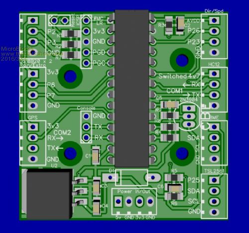

  MicroBlocks said
This is what i got so far:
You are so very good at doing PCB designs, please upload to TBS or email to me the complete set of files including Gerbers. I just sent you my direct email, so thanks for making some room in your PM to allow that.
This design is fine by me as it stands, even if I have to do a trace cut or two, and twist some transistor leads.
Of course even better if you can update to Lew's latest stable design.
Hank
