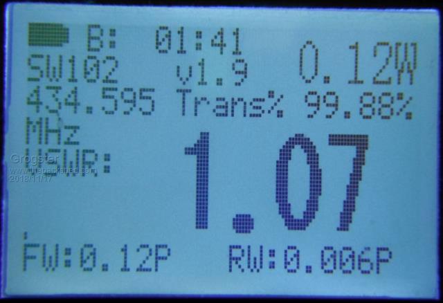

Well, I have had a chance to test both modules, and the genuine one registers fine on my SWR meter, but the clone has such a low output power, that it does not even see it - not a good sign.
Here is the genuine HC12 result:
This module is set for FU4 mode, +20dBm output, and channel 4(434.6MHz).
So, the SWR meter says we are actually getting 120mW out of it.

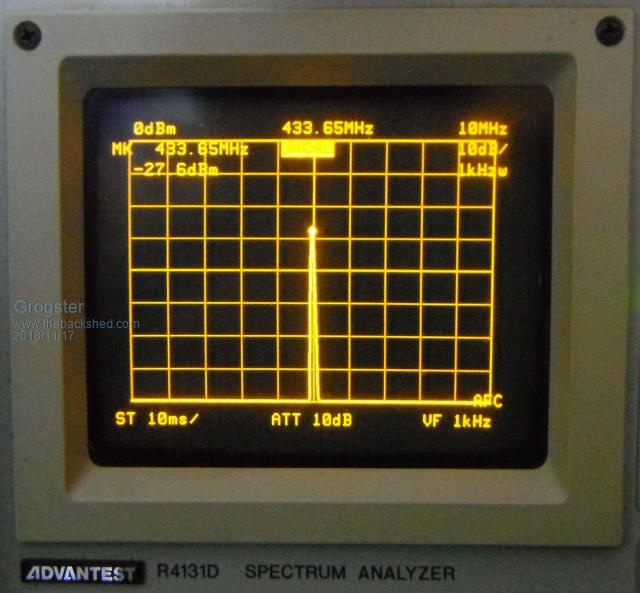

Here is the clone on the spectrum analyser:
So, yes, about -30dB down. On this scope image, the very top line is 0dBm, so the marker is showing -27.6dBm - not very good.
Data was just a stream of asterisk characters. I would manually stop the data-stream every so often, to prevent overheating the HC12 on-board regulator.
Spectrum analyser shows the CF about 433.65MHz, even though this clone module was set to channel-1, which should be 433.400MHz or so - quite a wee way off frequency, this one.... Edited by Grogster 2018-11-18

  Grogster said   Well, I have had a chance to test both modules, and the genuine one registers fine on my SWR meter, but the clone has such a low output power, that it does not even see it
[/quote]
Well, that's... probably good that you've confirmed my findings, but bad in as much as the clone units - even if "on frequency" are basically useless bits of junk!
[quote]
[/quote]

Have a re-read of my edited post above. Both modules were set to different frequencies, as that is just how I picked them up. I don't think that invalidates the test though.
The GENUINE one was set to 434.6MHz, and the SWR meter says it thinks it is 434.595MHz, which is close enough when compared to the clones.
The CLONE one was set to 433.4MHz, and the SWR meter could not see it's transmissions at all. The spectrum analyser could see it on 433.65MHz - but at 30dB down....
I suspect that that sub-standard crystal is behind all of this. Not only is it badly off frequency(see other thread), but it is also less then half the amplitude of a genuine one. I fully expect that the crystal is used for both the frequency of operation, and as a reference for the modulation - which would explain why the signal is so weak coming out of it.
