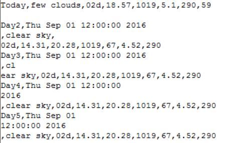

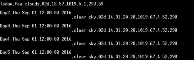

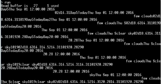

It's "KINDA" working
It now prints this
BUT prints every 4 items one after the other until it does this
FieldArray$(Count) = FieldArray$(Count) + Chr$(char)
Error: String too long
I think I need to clear the FieldArray$ when I close the serial port but not sure how to do this
I also need to put a line feed after each item is printed, I THOUGHT I had done that by adding ; at the end of the print statement

Here's how the info looks when viewed on Terraterm
and
here's how the info looks viewed on the MMEDIT console
The Function seems to me to be stripping the commas from the received data?
AND it also doesn't clear the count when it receives new data from the com port, it just adds it all up till it crashes
Edited by lew247 2016-09-01
