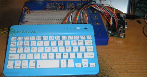

UPDATE:
Here we have the running prototype - excuse the rats-nest of wiring.....
...and the results on the console...
This is just initial testing - the code needs tweaked some more, but basic keyboard is working fine, and I have the 170 MM chip throttled back to 10MHz, AND with a 100ms delay between keypresses. Matrix scanner code is crude by some members' standards - just a whole heap of IF/THEN lines inside a loop. Loop completes in 25ms @ 10MHz, and is down to about 9ms @ 48MHz, but you don't need it to run that fast, really, just for scanning a matrix.
Posted: 02:26am 26 Aug 2015
Yes! Success!
Mine will take some more time.
Goes to show the power of a MM, from plan to working prototype in a very short time.

Posted: 03:04am 26 Aug 2015
  WhiteWizzard said  Can you clarify something for me please. What 'electrical connection' is being used to connect the keyboard to the MM for it to 'drive' the onboard console? Is it through a serial port? If so, which pins?
Also, is there drive for caps LED?
Hi-de-hi.
The output from this experiment is via the native MM console pins.
These would connect directly to the console of another MM, or any other serial port.
At the moment, the code basically ignores console RXD, and is an output device only.
'Power' LED on KB is lit, and blinks when you type anything(not shown).
'CAPS' LED on KB is driven from an IO pin, and the PCB I have made allows for both these LED's in their original locations, so they will show up through the case like they would have before I got hold of it. The other two LED's are NOT allowed for.
I only have lower-case working at this point - I need to add more flags for shift and caps etc, so that in the output routine, I can just make use of MM's UCASE$ function.

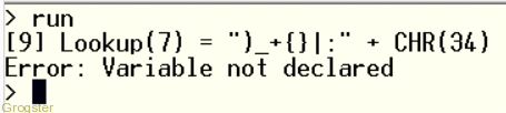

Hi. Result:
EDIT: Ignore - should be CHR$(34).....

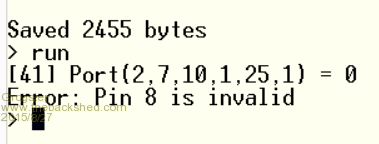

EDIT: Port errors:
Edited by Grogster 2015-08-28
Posted: 07:48pm 26 Aug 2015
Try
PORT(2,6,9,2,25,1)
JimEdited by TassyJim 2015-08-28
Posted: 07:59pm 26 Aug 2015
Thanks for testing! Some stupid little mistakes.
That PORT command is fighting me all the time. I would have preferred just a list of pins instead of the pin,count pairs just like in the other commands like LCD and KEYPAD.
I just got some mail. This weekend will be fun.
Edited by TZAdvantage 2015-08-28

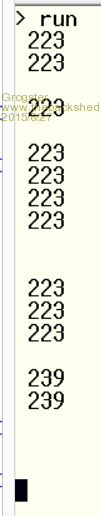

Results:
This is with the change you requested - OR changed to AND on line 75.
Posted: 11:29pm 26 Aug 2015
Well obvious something is not working as expected.
What should happen is that after a keypress is detected it goes into the ScanMatrix$ function which starts a full scan.
It does see the keypress but it does not determine which column.
The code should test each bit in the ScanCode for a 0.
If it finds one then you have a row and column number.
That IF statement after the FOR is not doing what i expected. I tested that in MMBasic for DOS and it worked. Is there a difference in versions when 64 bit integers were introduced?
If i just use
[code]
print (239 AND (2 ^ 4))
[/code]
i get 0, and that is right.
I'm puzzled.....
