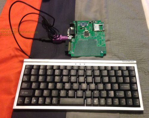

Posted: 01:47pm 17 Jul 2015
I use THIS one on my maximite. Works great with a usb to ps2 adapter and is pretty damn cheap.
