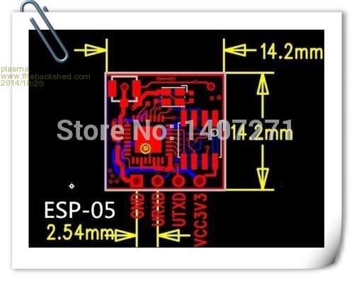

plasma
Joined: 08/04/2012
Posts: 437
Posted: 07:26am 20 Oct 2014
here is the pinout for the version esp8266-05 .
beware you cant update this version because lack of gpio
Edited by plasma 2014-10-21
