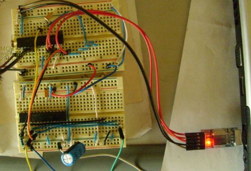

Hi, methinks there is more to programming a pic32 than MCHP let on - unless there is something I'm continually overlooking.
Is there any one game enough to also tackle the MicroChip documentation?
I've wired up two pic32 chips - the top one as a micromite and the other as the target chip to be programmed.
For anyone game enough, the connections are simple enough and are listed at the beginning of the code.
I would like to be able to get this working (if it is indeed possible) just using the MicroChip documentation - which is a challenge in itself.
The code so far should determine the status of the target chip, i.e it is ready to accept programming commands.
The pdf of the pic32 programming instructions is on the previous post to google and download.

Hi all, I think this might be my last night with WWW for a few days but then, we do get some mobile net anomalies in the outback.
@keith, the 4 phase clock sequence certainly looks workable. I am not convinced that the data is available on the PGD line at the third clock even though the charts seem to indicate. It is after all just a drawing and MCHP are notoriously inaccurate in their representations. (unless you have already confirmed with a logic analyser). I will give it a go though. Why I am concerned is that MCHP have gone to the trouble of including arrows on their clocks and as all timing is done by the programmer, I would think that they would certainly indicate the edge at which the data in or out is latched. That has certainly been the case in the past with PICF88 based programmers I have made for 8 bit pics and avrs.
I don't think any timing using the micromite would be too quick for the PIC32 it being an interpreted language, but worth experimenting with.
I think that leaving PGD as an input until required otherwise could be a good idea to avoid having pin polarity clashes - not really sure it can though.
I'll plug in my dongle and have a bit of a play with the code, bearing in mind the suggestions made. Don't go getting too far ahead of me whilst I'm AWOL. (just kidding, its a free world)
I tried the modified the 4 phase clock routine to that suggested but with the same results as previous. - back to the drawing board. Running out of hair.
