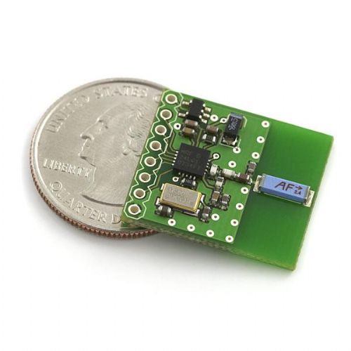

This NRF module come with integrated antenna and have 100m range and "pins" are 5V tolerant:

AFAIK,the sad thing is RFM12B module is cheaper than the Nordic module from SpakFun.com. Anyway, it comes in an unfriendly package, is not 5V tolerant (that is ok for Micromite) and in my opinion (unless I am corrected with a working C implementation) is still more work to implement it than the Nordic module.
