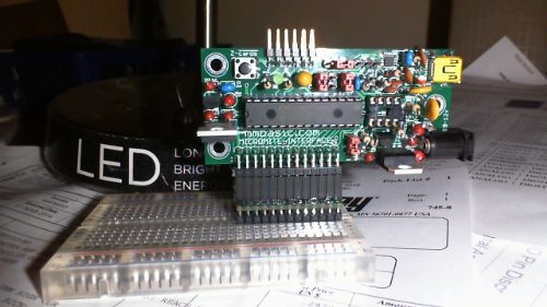

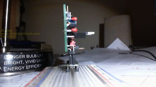

Ok... Just got back from Lou's place, after spending the afternoon getting the stuff organized. Lou managed to get another DFN stuck on using a mag-lamp and a good bit of luck.. So, I think it's going to be doable. The good news is the boss at work let me take off a week so we can get a double teem thing going on these units. One thing I would like to try is using a fitting jig to make sure the part is sitting just right. I was thinking of using a tiny drop of that lock-tight SMD glue to stick the part to the PCB, let it dry, then try soldering it. I hope it would be an easier operation without worrying about the part moving around as your moving the iron around. Anyway, I fitted a right angle male connector to a finished board an plugged it into a 200 to 300 center converter board.
Mounting it vertical seems to leave plenty of space on the vector board...

EDIT: After a trip to Lou's place to grab the parts, I got setup at work and spent the morning creating a reference jig to hold the DFN's in place. With the help of the nice staged microscope at work, I managed to get 4 of the DFN,s fitted to the PCB's... I think I'm getting the hang of this... The jig is working great..! I hope to put in more time at it tomorrow..
