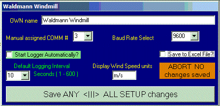

This is the screen for Hardware setup.

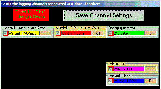

This is the screen for channel setup.
This is for setting up personal logging XML identifiers.

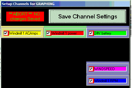

This is for setting up initial preferred channels to graph.

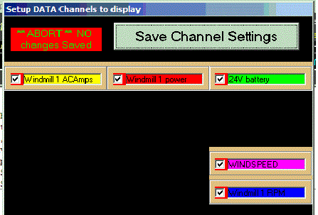

This is for setting preffered channels to display in real time.

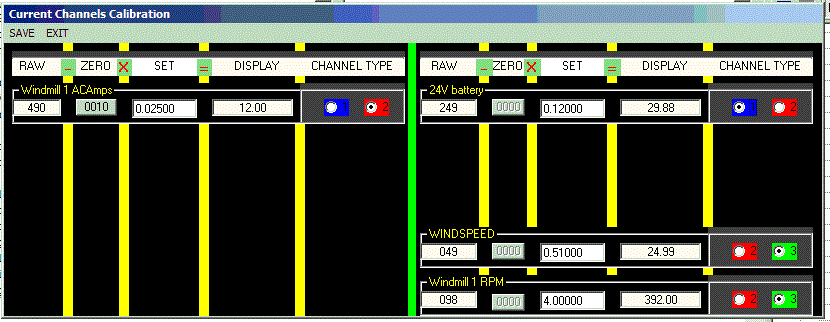

This is the calibration window.

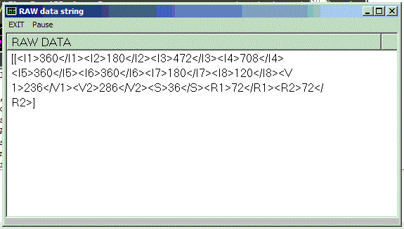

This is the RAW comm data display. Readers may have seen it on my little comm sniffer app.

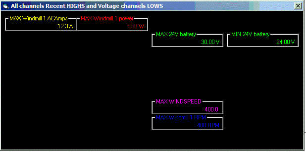

This is the maximum/minimum for the day window.

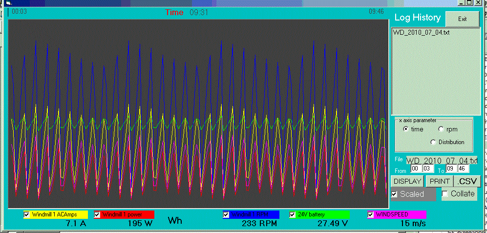

This is the Graphing window for viewing historical logged data.

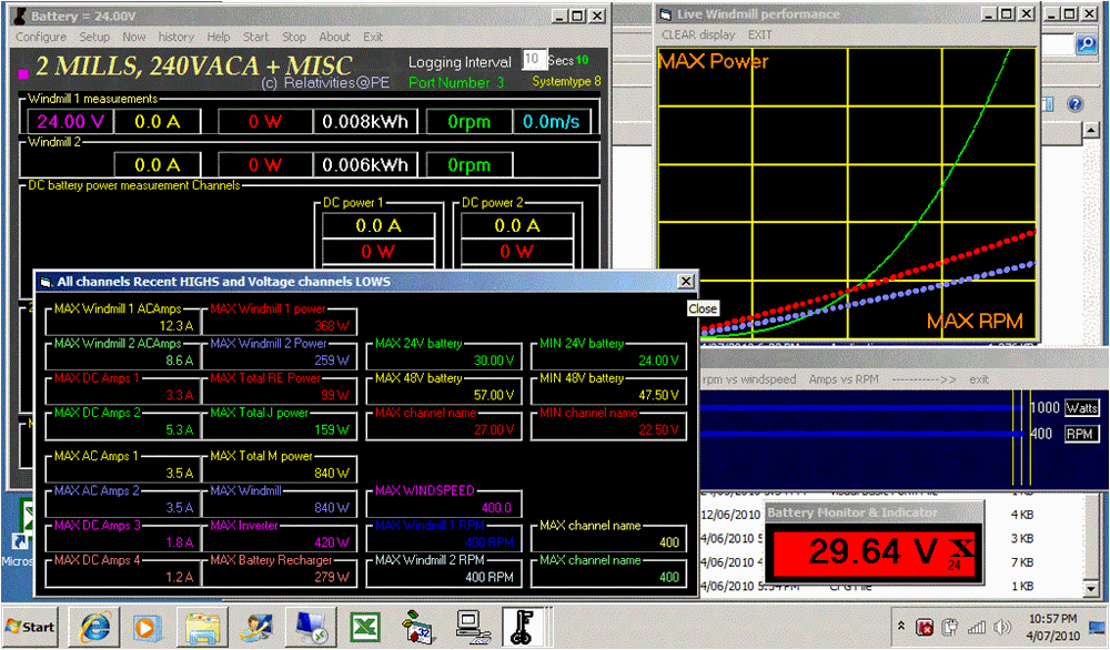

Here is a cluttered screen shot of how things could be. I am running a test program and not real data here.
By breaking the screen down into smaller windows that can be positioned anywhere allows the user to determine what is needed. Some care was taken in behind the scenes coding to keep things in order though.
To save cluttering the main window, each of the measurement output displays has multi functions. When the cursor is clicked on say, the voltage, then for each click, the maximum or minimum for the day is displayed for a short interval, between data updates from the logging hardware. This has saved so much data display and identification space, and has allowed me to use larger fonts, so I don't need my glasses to read the numbers on screen. I have provided this, in addition to a separate window with the collated data. I have tried to make the screen layouts clear. I have restricted some of the flexible aspects as making the programming too flexible would defeat a lot of the calculating aspects that I have included.

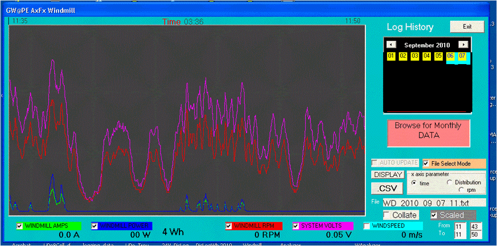

Here is a pic of a previous 20min live update graph. I flipped to calendar view just prior to screen capture, so this could be seen as well. I normally use scaled graphs, so day to day performance is clearly shown on the graphs. If automatic scaling is used, then day to day performance graphs can look the same. Readers may question what the Voltage is doing. This is the windmill output voltage, and not just the battery voltage. This shows that windmill current is supplied below the battery voltage and indicates operation of the cap doubler.

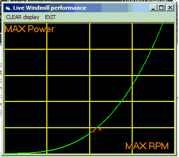

The latest revision still in development is basically a scaled, gridded, graphing window with a menu structure. My latest NetPC has a small screen, so I am optimizing the window size for it, and buttons take up screen real estate. Hopefully the touch screen laptop will have higher screen resolution than my NetPC.
I have to admit that viewing a live updated graphical representation is really cool. The simplest analogy would be the difference between a CRO and a multimeter.
