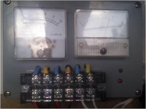

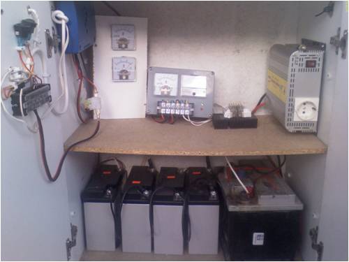

Posted: 10:05pm 21 Feb 2010
this is finally my controller up and running it dumps at
14.6v and stops at 13.4v
Now i need a dump load for my setup but i believe i must go to an other thread.
Again thanks for your help.without your help i'll probobly give up.
Posts: 5200
Posted: 10:15pm 21 Feb 2010
Glad to see you got it sorted out. Nice looking set up.

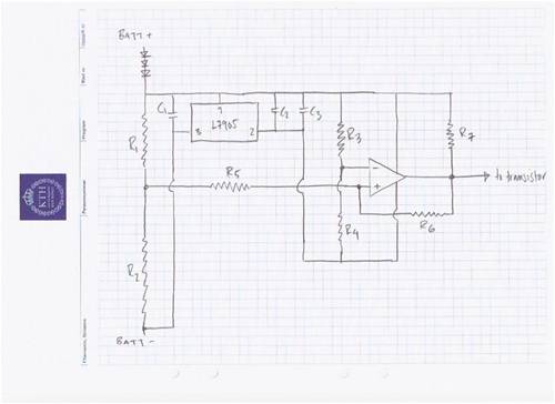

i was inspired by Gizmos controller and by the one Oztules helped create in the otherpower-thread (very helpful facts there actually). i want to design a controller using components that is easy to find in discarded electronics (yes, i know what you think Pete, but thats just how i am).
the quad. voltage comparator dbl 339 seems to be quite common, i have found 3 in different audio equipment. and in almost every PC power box there is a negative voltage controller, L7905cv, together with all diodes and condensors you may need.
i've already sucessfully built Gizmos controller, but i'm not really satisfied with haviing bought some of the components. so i want to build a simple controller to keep the batterys from harmful deep discharging (this way im not really reinventing the wheel?).
so i kind of stole some from Gizmo and some from Oztules and ended up with this:
but i have a problem: when i use a negative v.contr. i get a different "ground" in the OP-circuit than the battery ground (-).
when the OP-out is low i dont get v=0 but rather like 6v. and i think i need to connect the transistor/mosfet to the battery- pole to get it do work? (it will controll a relay like in Gizmos controller). seems to me my transistor will always be open...
anyhow... with r1=8,2k r2=20k r3=33k r4=12k r5=1,2M r6=1,0M r7=3,3k i hope to get OPout high when Ubatt=10,89v cutting the load from the battery bank. then the hystersis sees to it that the load is not connected (OPout gets low) until the Ubatt rises to 12,19v.
this is if my calculations are correct of course.
is there any way to run the transistor using this setup?
i do have a L7805cv that makes things much easier, but they are not quite as common i think?
any thoughts?
no need to be polite... i know i dont really master this, but you learn by trying, right?
/jonathan
GWatPE
Joined: 01/09/2006
Posts: 2127
Posted: 12:33am 27 Feb 2010
Just use an opto coupler to DC isolate the sensing from the control element.
Gordon.

Posted: 02:17am 27 Feb 2010
Why not intergrate this circuit into Gizmos charge controller and use the same v-reg (7808)
That way 1x v-reg will do both circuits.
This gets rid of the 7905 and solves the problem as there is no need to have a seperate v-reg for each circuit.
What Gordon said will work but it will cost you more than buying a 7805 which as you know will solve the problem too.
Just make sure the relay dont disconnect the circuit from the batteries too.
10.89v would seem a bit to low to me.
Pete.
adonis
Joined: 13/02/2010
Location: Sweden
Posts: 42
Posted: 07:16am 27 Feb 2010
haha. yes thats a good idea Pete, i never thought of that. but i dont really whant to mess with the other controller, im quite surprized that one works (you dont whant to see inside that box...).
Gordon, i have no idea what an opto coupler is, but if you dont easily find it in used up electronics its not really helping... the goal here is all out recycling!
i already have a 7805 i found in some computer, but i really would like to use 7905 since it is so common...
but maby i will have to go with the 78. well well thanks for your interest.
and Pete, i would like to complement you on your guide on making a dump load out of heater element. very nice walkthrough, im gonna make me one of thoose...
oztules
Joined: 26/07/2007
Posts: 1686
Posted: 07:43am 27 Feb 2010
A lot of the earlier high side single switch PC power supplies had opto isolators in them, so should be easy to find. Most CD or DVD players will have them in their supplies as well, set top boxes, satellite reciever boxes etc.. They are very common and almost mandatory for single switch pwm supplies in most consumer goods now. (no one uses transformers any more it seems)
A lot (most) pc power supplies have TL494 or ##494 or KA7500 PWM controller chips (they all the same. There are other numbers which escape me at this moment too which are still the same chip).
They have two op amps built in, and a 5v regulated output as well..designed as a stable Vref for the op amps to use...... and a PWM output if you want to use that.... so everything you need in one very very easy to find package. Check the data sheets for internal circuits to see what you can exploit.
Most PWM chips will have an op-amp or two, and a stable Vref output.
..........oztules

Posted: 07:47am 27 Feb 2010
thats perfect for me it seems! you really understand what kind of input im hoping for here, thanks.
now i will have to go through all my junk once again, my wife will love that!
adonis
Joined: 13/02/2010
Location: Sweden
Posts: 42
Posted: 08:03am 27 Feb 2010
i did a quick checkup on the TL494, and i could not spot any OPout pins, they seems to be connected inside? but even if i dont manage to figure that out it is a perfect 5v pos.regulator. and you are right, i think they are very common.
thanks.
adonis
Joined: 13/02/2010
Location: Sweden
Posts: 42
Posted: 09:05am 28 Feb 2010
i cant really figure this one out.
but you are correcct Oztules, it seems to be everywere!
there is a output from the two OP-amps (the outputs are connected, so they can only be used as one). the 5v Vref can give a maximum of 10mA, it is mainly there to drive the chip. but the chip also has two transistors controlled from inside the chip. they have a Imax of 200mA each, its a bit cheap but they can easily be connected in series, so i suppose they can be used to control the relay.
if someone figures out how to "disconnect" the PWM-part, and the pulsing, so that the error amplifiers directly controls the transistors, this chip, a few resistors and a relay is all thats needed...
i will give you geniouses a few days before i use my 7805.
Pete- i was not sure what voltages to use for cut in/ cut out. please advise me on that.
i suppose i could post the question on some electronics-forum, know about any good ones?
/jonathan
