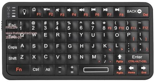

Would it be possible to get info on the Bluetooth keyboard / mouse connection in the PicoMiteBTH build? Could this then be used to force a re-connect to the same device?
I have a few Bluetooth keyboards that can connect to the PicoMiteBTH, as sods law would have it, the cheap crap ones re-connect every time either the PicoMite or keyboard is power cycled, however the better quality Rii unit I want to use needs to be re-paired on every power cycle. Not a big problem in the larger scheme of things but the position of the switch requires the keyboard to be removed from a prospective device to re-pair.
This is the unit that does not re-pair: (Rii518bt)
Thanks again.
Regards, Lyle.
Footnote added 2026-09-20 17:24 by mozzie
Just tested on PicoMiteBTH060302b12 and its only power cycling the Picomite that causes the problem, power cycling the keyboard it re-connects OK.
