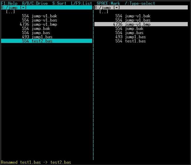

I am using FM more and more now that it's there. Discovered a little update thing. When I have the same library open in both windows, and rename a file, the filename does not update in the other window.
/Peter63

Posted: 02:45pm 19 Apr 2026
I checked FM. It works well.
I noticed a few things.
- If you start a .bas program from FM, it cannot be stopped with Ctrl-C; it only works after pressing Ctrl-C 3 times, after which it returns to FM.
- From FM, you can start it using Select and F2 EDIT. This works, but I tested it with an RP2040/16MB and it takes 3 seconds to start, and with an RP2350/16MB, it takes even 6 seconds.
The question is, what causes this delay?
> help fm
' FM                             'File Manager
' Speed ​​up FM via USB version:    OPTION BAUDRATE 921600.
' Arrow keys/Home/End/PgUp/PgDn:  Move      selection.
' ^E/^X/^U/^K/^P/^L:              Move      selection.
' TAB/LEFT/RIGHT or ^S/^D:        Toggle    Active Panel.
' ENTER:                          Open      Directory Folder.
