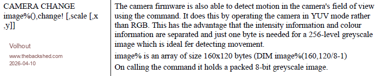

On CAMERA
Appart from mentioning 252MHZ clock speed, there is also a bug in the manual.
The image%() array must be 1 dimensional.
DIM image%(160*120/8-1)
P.S. in this version, camera is not closed when doing a new RUN. Or stopped when the program ends.
