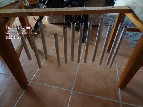

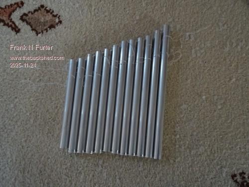

Posted: 02:36pm 23 Nov 2025
Here is my first (and hopefully only) attempt at making sound tubes:
An initial sound test sounds quite promising:
Frank

Posted: 11:02am 27 Nov 2025
Hi Frank,
this isn't meant as criticism, but I doubt the (wind) chime idea will work. That's because the tubes can't be fixed, and the point of impact  - since the tubes move - isn't constant. I found the xylophone/glockenspiel idea (metal plates) more convincing.
But it's probably too late to change the concept.

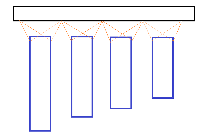

Posts: 3416
Posted: 11:29am 27 Nov 2025
I also wondered about stability but perhaps a triangulated suspension will be sufficiently stable.

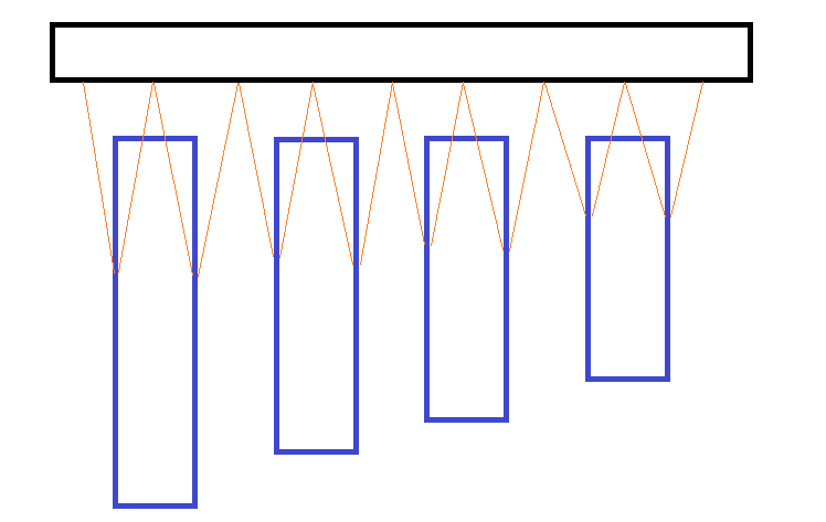

Posted: 08:57pm 27 Nov 2025
@twofingers:
Michael, that was just a test to see if the tubes sound good together. Metal plates would have been more difficult to manufacture (above all: where would I have gotten the right formulas for calculating the frequencies? ).
@phil99:
It's hard to see in the photos. The suspension points have been calculated and are unfortunately very far towards the center of the pipe. For the longest pipe, it's 76.2 mm. Unfortunately, this makes a triangular suspension very difficult to achieve.
I have found that, surprisingly, the tubes also sound good when they are suspended with bell wire (...is bell wire the correct term???). This allows them to swing in only one direction. I would like to try connecting them all together with a thread. That would then limit the remaining degree of freedom.

Posts: 3416
Posted: 09:17pm 27 Nov 2025
Plan "B"

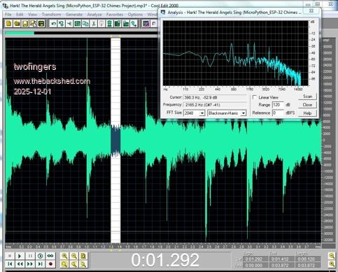

I watched the YouTube video (Hark, the herald-angels sing, https://www.cpdl.org/wiki/images/5/54/AMNS_35_Mendelssohn_Harmony.pdf). You're right. The tubes move less than I would expect. That's probably due to the weight of the tubes, as well as the low impact energy. Something you should take into account. The spring tension probably needs to be considered in particular.
However, the sound isn't good to me - as a non-musician, a bit off-key, not to say wrong. But that has its charm, too.
I should perhaps add that I like "keredson's" (Derek Anderson's) project and respect his work.
I downloaded the YouTube video as an MP3 and fed it into Cooledit. It looks like this:
I'm curious to see what you find out...

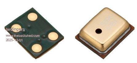

I've also ordered two microphones:
  Quote  The SPU0414HR5H-SB is a miniature, high-performance, low-power, top-port silicon microphone. Using Knowles’ proven high performance SiSonic™ MEMS technology, the SPU0414HR5H-SB consists of an acoustic sensor, a low-noise input buffer, and an output amplifier.
Perhaps the Pico can record and analyze short samples?
