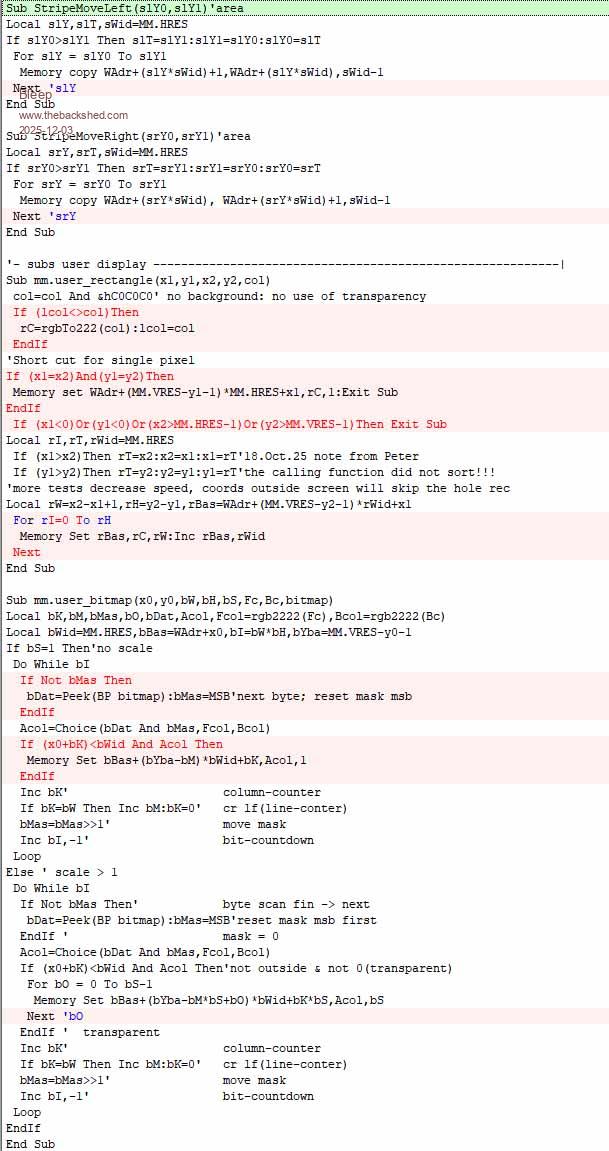

Bleep
Joined: 09/01/2022
Posts: 864
Posted: 06:12pm 30 Nov 2025
Hi Albert,
Further speed ups for BMP Blit etc.
On my setup, loading a BMP has gone from about 3 seconds to just over 1 second, doesn't seem to slow anything else down noticably.
'These two variables need to be global now.
Dim Integer Rc,lcol=-1
Sub mm.user_rectangle(x1,y1,x2,y2,col)
'We only want the top 2 bits of first 3 bytes
col=col And &hC0C0C1
'Check if colour has changed
If lcol<>col Then
rC=rgb2222(col):lcol=col
'Short cut for single pixle
If x1=x2 And y1=y2 Then
Memory set WAdr+(MM.VRES-y2-1)*MM.HRES+x1,rC,1:Exit Sub
'I hope you know what you do, coords outside screen will be skipped
'more tests will decrease speed
If x1<0 Or y1<0 Or x2>MM.HRES-1 Or y2>MM.VRES-1 Then Exit Sub
'multi pixels here
Local rW,rH,rI,rBas
If x1>x2 Then rI=x2:x2=x1:x1=rI '18.Oct.25 note from Peter
If y1>y2 Then rI=y2:y2=y1:y1=rI 'the calling function did not sort!!!
rW=x2-x1+1
rH=y2-y1
rBas=WAdr+(MM.VRES-y2-1)*MM.HRES+x1
For rI=0 To rH
'  base-address + row*MM.HRES + x-pos,color,count(wide)
  Memory Set rBas+rI*MM.HRES,rC,rW
Next rI
Edited 2025-12-01 04:41 by Bleep

Joined: 09/01/2022
Posts: 864
Posted: 09:42am 01 Dec 2025
Interestingly if you are trying to squeeze the last bit of speed, changing the way you do end of line comments makes a noticable difference, so instead of:-
bYba=MM.VRES-y0-1          'calc outside loop
bMas=0                     'init val to read byte first
bI=bW*bH                   'all-count
bK=0:bM=0                  'init
Do This
bYba=MM.VRES-y0-1'          calc outside loop
bMas=0'                     init val to read byte first
bI=bW*bH'                   all-count
bK=0:bM=0'                  init
I assume this is because the parser continues looking for code until it find a comment or line end?
Also Next loops are faster without the return lable so:-
 Next i
Next j
Do this
 Next 'i
Next 'j
No idea why this might be, try it in your StripeMove routines, in some places as in after a Next, if you put the comment immediately, when you save the code the editor inserts a single space, again not sure why?
Regards Kevin.

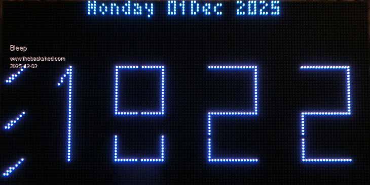

Continuing with the theme of clocks, here is a ClockClock24 on the 128x64 panel. :-)
Video
Regards Kevin.

Hi Kevin,
a digital clock consisting of many analog clocks, a nice idea. Is it yours?
Do you only use system commands, or have you written your own line- and rotate-function?
When I have some time, I'll try these.

Not my idea, if you search for clockclock24 you'll find lots, it uses standard drawing commands I calculate the coordinates for drawing with them.
I like the Tetris clock that will look nice when finished.
Regards Kevin.

thanks to Kevin's(Bleep) suggestions, I found a few more areas for optimization and have also incorporated his improvements into this version.
Kevin suggested making the “last color” global, and he was right. The ‘static’ variables worked, but they were slower than the “global” variant.
Since color conversion seems to be time-critical, I have now used a pre-calculated color table.
I have no more ideas how I could further optimize the “USER driver.”
I think this is the final version.
Hub75UserGen.zip
Best regards,
Albert

I've tested you latest driver all looking good, thank you, I have been able to speed it up a little, my speed test is to run all of your checks from the driver, removing all the Pauses, I also add a load BMP of 128x64 then StripeMoveleft the whole screen 128 then Blit load the same BMP and Blit Write it across the screen in steps of 16.
With the driver as above it all takes 30.3Sec, if you make the changes below it drops to 28.13sec.
I have unrolled some 'If' statements, for whatever reason it makes them faster, maybe it is to do with whether the 'If' succeeds or fails most of the time? also removing the loop identifier on Next for the StripeMove subs improves them. :-)
Hope this is of help.
Regards, Kevin.

I have incorporated your changes. I wasn't aware that the move function was used so much. I've made a few more changes here.
Sub StripeMoveLeft(slY0,slY1)'area
Local slT,sWid=MM.HRES,sDec=sWid-1
If slY0>slY1 Then slT=slY1:slY1=slY0:slY0=slT
Local sSrc=WAdr+slY0*sWid,sEnd=WAdr+slY1*sWid
For slT=sSrc To sEnd Step sWid:Memory copy slT+1,slT,sDec
Next ' slY
Sub StripeMoveRight(srY0,srY1)'area
Local srT,sWid=MM.HRES,sDec=sWid-1
If srY0>srY1 Then srT=srY1:srY1=srY0:srY0=srT
Local sSrc=WAdr+srY0*sWid,sEnd=WAdr+srY1*sWid
For srT=sSrc To sEnd Step sWid:Memory copy srT,srT+1,sDec
Next ' srY
I can't explain why it's faster when the loop-start is on the same line as the statement and the “next” is on a new line. Maybe Peter can say something about that.
The collected improvements in zip.
Hub75UserGen.zip
