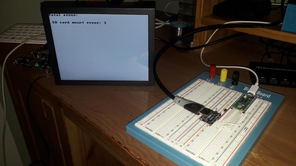

Posted: 07:06pm 07 Feb 2025
Hello javavi,
HDMI works solid, even if I touch and move the breadboard wiring. But can't test further, no sd socket at hand and no game. If you have another test with audio in which I don't need an sd card what so ever I can try it.
Here is a picture:
Greetings
Daniel

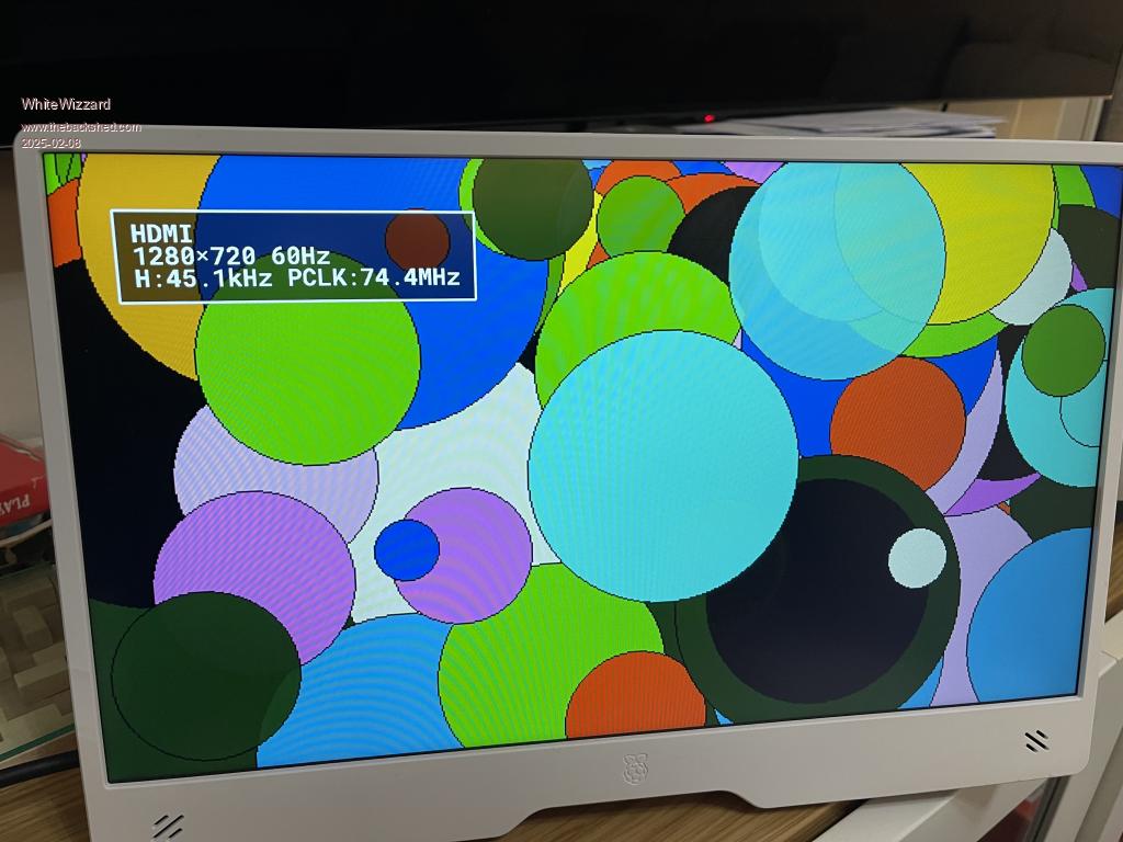

With your new monitor, and the Pico set to OPTION RESOLUTION 1280, would you please be able to tell me what frequencies you are seeing in the monitors ‘info’ window.
I am seeing the following BUT this may be dictated by the ‘splitter’ I am passing through.

@ WhiteWizzard
  Quote  what frequencies you are seeing in the monitors ‘info’ window.
Hmm at first I have to find such an "info" window

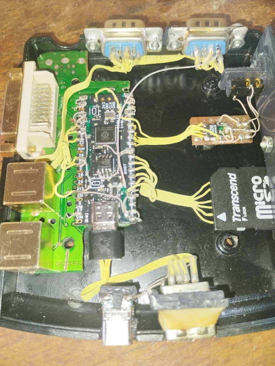

Posted: 09:05pm 07 Feb 2025
  javavi said
er. tidy wiring
Amnesie

Posts: 3417
Posted: 09:21pm 07 Feb 2025
@Stan. When the lid is on it will be as tidy as a bought one!
The recycling and reuse of old equipment rather than dumping it and buying new is to be applauded. A high proportion of my projects are in a similar style.
Edited 2025-02-08 07:24 by phil99

Posted: 10:39pm 07 Feb 2025
  phil99 said  @Stan. When the lid is on it will be as tidy as a bought one!
I'm as tight as a ducks bill and recycle everything.
