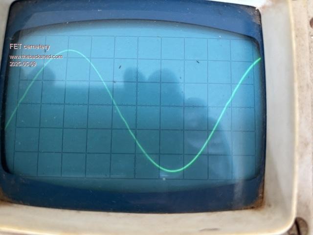

If you look at the original scope picture (I managed to post it upside down) there's a tiny wobble just after the zero crossing on the downslope. Does this mean anything? This was feeding a tiny 300mA 240 to 9V transformer, using the 240V as primary so the scope was reading about 0.5V. 4.7uF across the output.
Yes it is close to running, if something was drastically wrong there would be no sinewave.

The original scope pic from the bench test, right way up. You have to squint to see it but there's a tiny kink in the waveform after the zero crossing.

Inverters are a but kinky - the small kink you see is quite normal, on some it is a little more pronounced others a little less. I think yours is normal/fine.

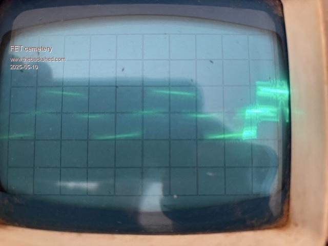

Posted: 07:36am 10 May 2025
Oreo, chokes measure 35uH each. This choke, transformer and capacitor combination are in use on my egs002 / powerjack inverter at the moment with no problems other than a bit of a buzz at 4+ kW due to the limitations of what's driving it.
Revisited the bench test with a more appropriate capacitor and powering through a 1A fuse rather than the light globe. All at 18V.

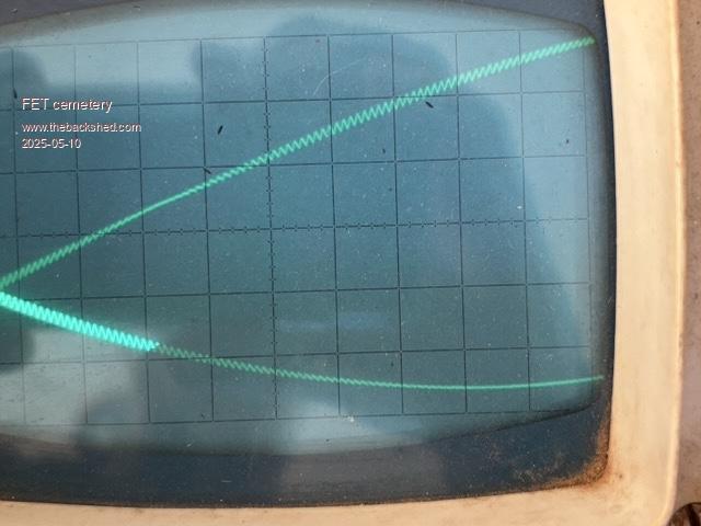

Scope straight across the output terminals, no transformer:

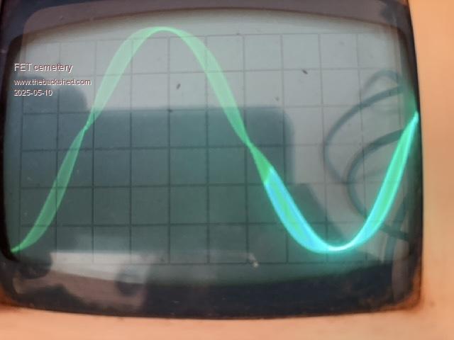

Output driving the 240V primary of a tiny 300mA transformer, scope across the 9V secondary:

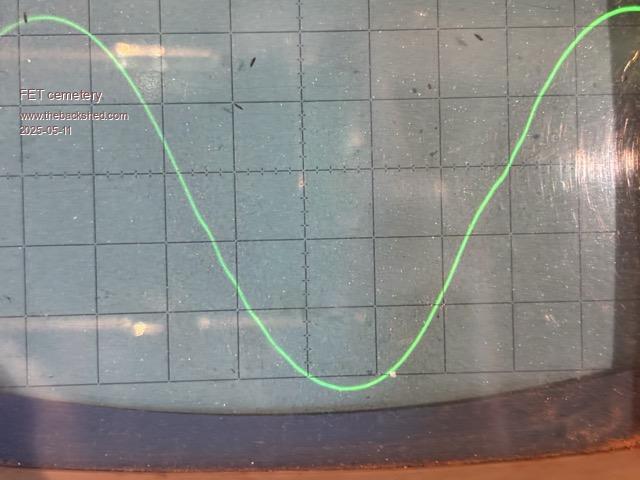

100nF and 2k2 in series across the transformer secondary, scope across the capacitor:
Zooming in on the timescale you can clearly see the pwm:

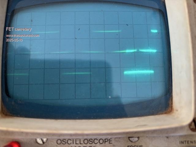

Even more obvious when the resistor is removed:
Edited 2025-05-10 17:39 by FET cemetery

FET cemetery
Joined: 17/04/2024
Posts: 75
Posted: 07:47am 10 May 2025
Interestingly, not even a hint of zero crossing wobble in the third image above.

KeepIS
Joined: 13/10/2014
Posts: 2284
Posted: 10:42pm 10 May 2025
With low value of caps a 2A fuse and reduced voltage there is almost no chance of damaging the FETS. But I agree, after all the work you put in, it's safer to bring the current limited voltage up slowly, so far everything appears to be good with the globe removed.
FYI, the 1A fuse should be fine for 18v to 53V as Idle power should not change much at all.
I assumed you were driving the Toriod with the revised setup?
So just to clarify the last 3 CRO images, were these taken driving the Toroid and the small isolation transformer across the AC output and feeding the CRO?
Edited 2025-05-11 13:40 by KeepIS

Joined: 17/04/2024
Posts: 75
Posted: 04:40am 11 May 2025
No toroid in these pics just the little transformer. Have to partly dismantle the existing inverter to test with the toroid. Might give it a go at 18V once the powerjack setup has finished running the kiln.
Edited 2025-05-11 14:43 by FET cemetery

KeepIS
Joined: 13/10/2014
Posts: 2284
Posted: 05:37am 11 May 2025
Thanks, would like to see if it was the unstable supply causing some or most of the problems, if I had the correct globe I could test it myself.
FET cemetery
Joined: 17/04/2024
Posts: 75
Posted: 06:30am 11 May 2025

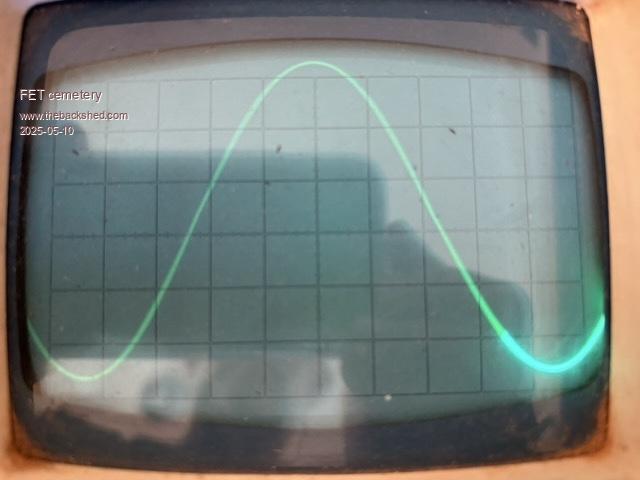

OK, tried it with the toroid and a 1A fuse at 20V (fully charged drill batteries) and the problem / hum is worse. At 40V the fuse blew, but not before I saw 237V output and pwm down to 98%. Something weird is going on. About 700mA at 20V, clearly more than 1A at 40V.
The hum at idle is worse than the buzz when it's being driven by the powerjack board at 4.3kW.
The fact that it is worse with a more stable supply voltage is consistent with it being worse still with the big 5600uF capacitor I think.
Waveform with 20V in, 115Vac out, the zero crossing kink is back:
I'm leaning towards the KeepIS gate resistor antenna theory, they're sandwiched between the PCB copper and the Al heatsink with only a couple of mm clearance, but I really don't know.
Putting it aside for now until the power supply arrives.
