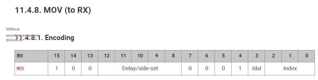

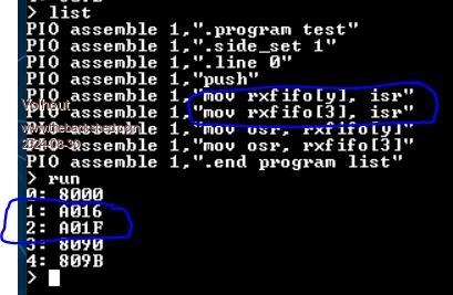

I think the "mov rxfifo[], isr" does not work correct.
When the datasheet is correct it should translate to something starting with &h80xx
Posts: 12068
Posted: 01:43pm 30 Aug 2024
Can you post your test program please - thanks. I think I had a |= rather than an =
Edited 2024-08-30 23:43 by matherp
Posts: 6198
Posted: 03:11pm 30 Aug 2024
That is the whole test program, these 8 lines. I did not arrive at executing anything yet...just the lines PIO ASSEMBLE 1, ....

Should fix the PIO issue above

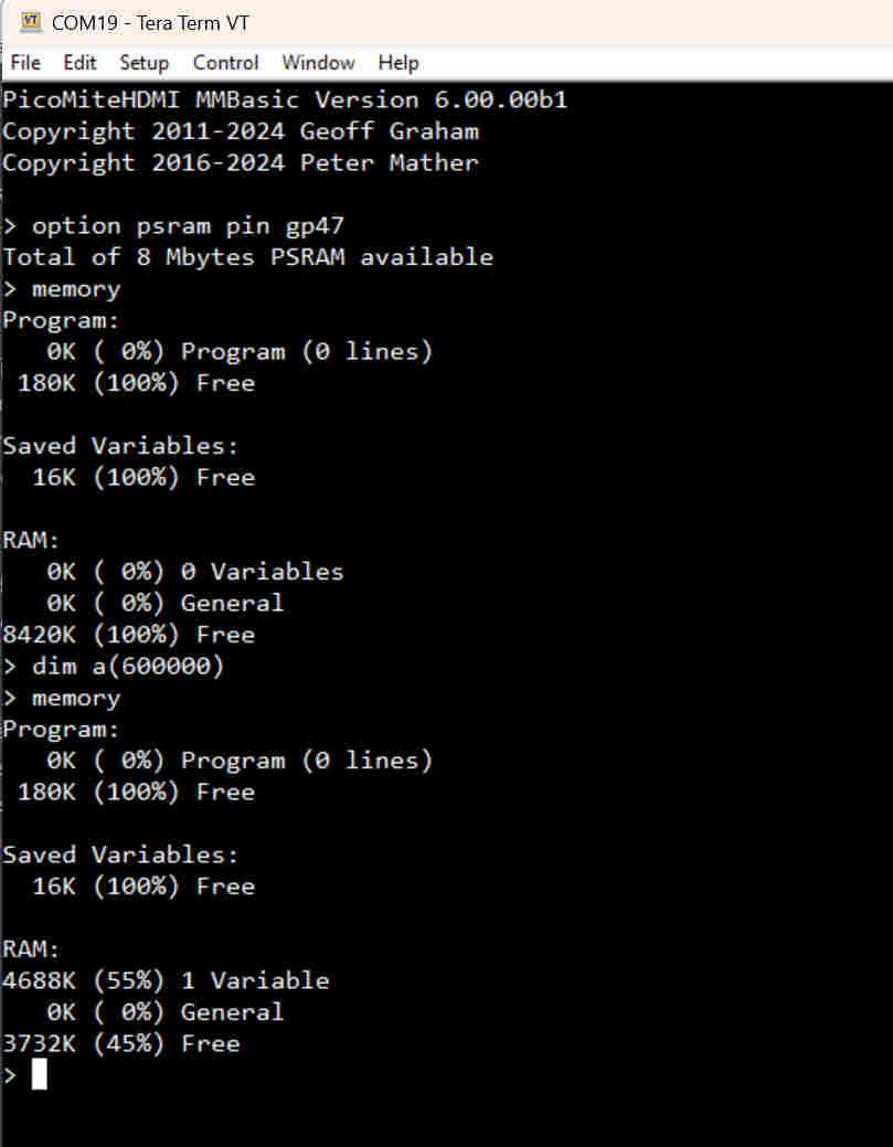

All versions now support PSRAM if enabled with
OPTION PSRAM PIN pinno 'pinno is typically GP47 for Pimoroni boards
When enabled PSRAM can be used like normal ram to store large arrays/strings etc.

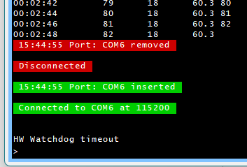

The PAUSE bug has returned.
PicoMite RP2350B, B0 firmware, default options
This code will run for a few minutes to a few hours before locking up. The Hardware Watchdog does it's thing but a software Watchdog fails to restart.
Edit: The first run on b1 failed after 13 minutes.

The print statement was split before and after the PAUSE ro confirm that it is the PAUSE that is the culprit.
Remove the comments from the SETTICK and the empty loop and SETTICK is used rathhheer than PAUSE 2000
Then it appears to run for ever (well tested for 10 hours so for)

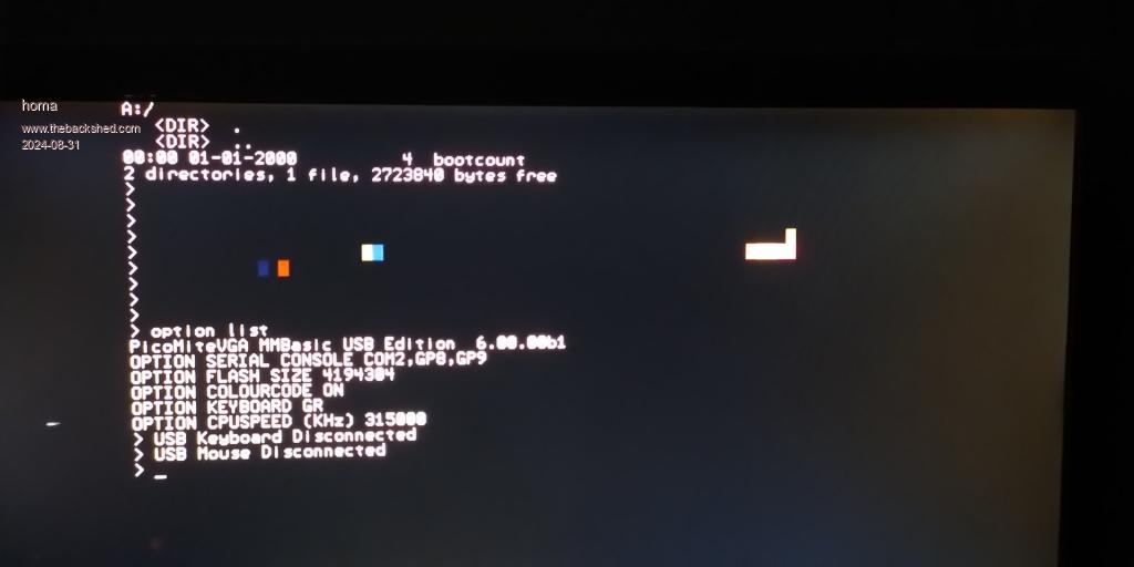

I have graphical artifacts with the "files" command. See picture.
@Peter: Is there a way to prevent the message that a keyboard has been connected/disconnected? The reason is that I use a switcher ... PC/Pico2

I see the same artefacts. Only in mode 1. Modes 2 and 3 are ok.

Should fix artifacts in HDMI mode 1
