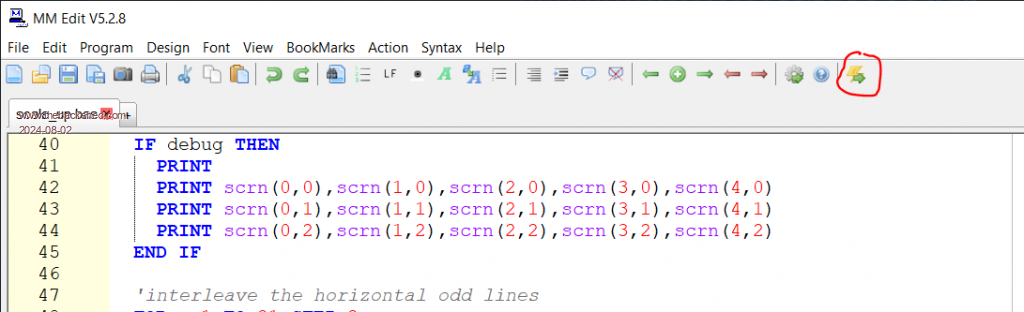

If you have either windows or linux, install MMEdit please.
MMEdit
You will be amazed what this can do. No more commands typing.

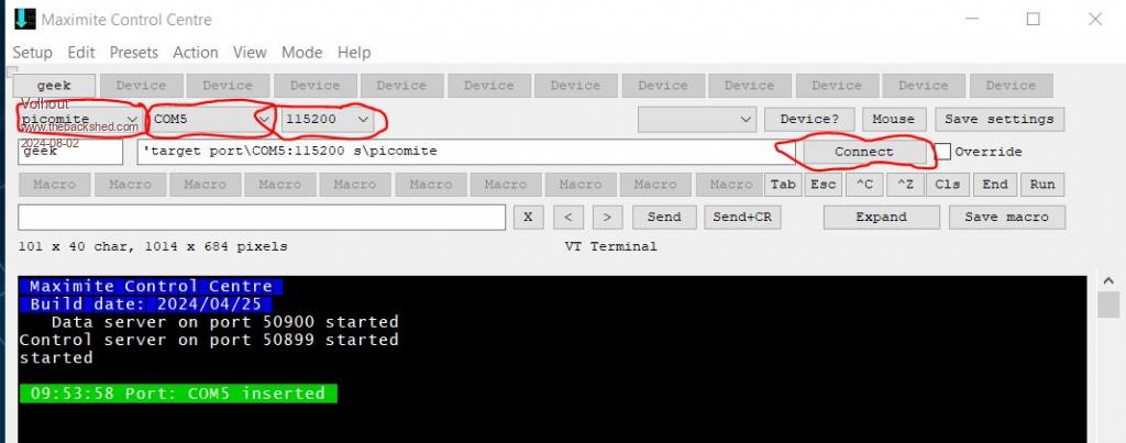

When you have installed:
- open MMCC
- select COM port
- Select PicoMiteVGA (or PicoMite)
- Press "CONNECT". In the text field a green message is shown that it is connected.

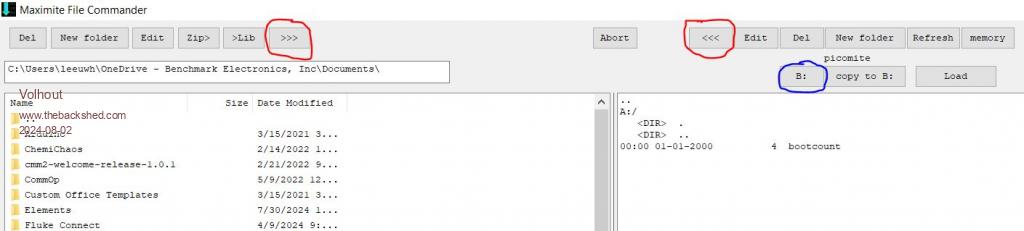

Then open the file manager
- press MODE
- select file manager
You can select files, and using the ">>>" and "<<<" buttons copy them. Change the drive with the blue button (A or B on PicoMite) Right side is the PicoMite, left side is the PC.
When done, close the file manager.
