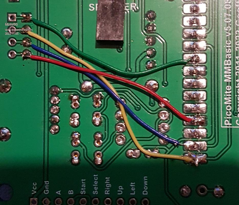

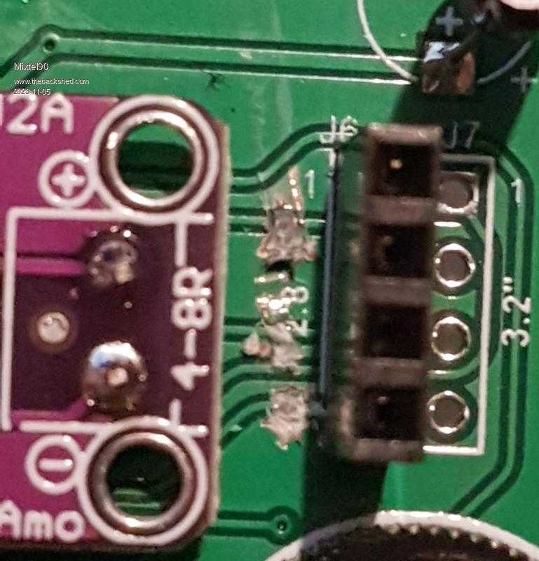

Posted: 05:26pm 04 Nov 2023
The display and touch are using SPI. On the standard construction the SD card is also connected to this. We can transfer it to different pins. We'll use GP16, GP17 and GP18 as the SD card doesn't need hardware SPI.
In order to split the SD card SPI from the display and touch:
Using a sharp knife or, possibly a very fine Dremel tool, you need to identify and cut the following three tracks. They are all between the PAM8302A and the connector J6 so it's a bit fiddly.
The one just underneath the figure 1
The one under the figure 2 of 2.8
The bottom one
Don't cut the track between the 2 and the bottom track. If you there's a work-around. :)
Pins 2,3 and 4 of J6 and J7 should now be isolated from pins 5, 6 and 9 of the PicoMite.
Now, on the back of the PCB, fit three wire links:
J6 pin 2 - GP16 (pin 21 - yellow
J6 pin 3 - GP17 (pin 22 - blue)
J6 pin 4 - GP18 (pin 24 - red)
If you cut the track mentioned above that's in the way (like I did) you'll need an additional link:
J6 pin 1 - GP22 (pin 29 - green)
Now the software has to be changed to work with the new arrangement. Change OPTION SDCARD to the following:
OPTION SDCARD GP22, GP18, GP16, GP17
This keeps the original SD_CS as GP22 and moves SD_CLK to GP18, SD_MOSI to GP16 and SD_MISO to GP17.
I've had this mod working today.

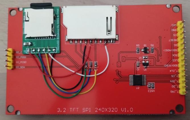

Posted: 11:45am 19 Nov 2023
My Game*Mite display is now retrofitted with a push-push uSD card adapter, PCB by @bigmik
"Yes", the soldering is a bit ropey and I should probably shift the adapter down the board by ~2mm to reduce the risk of it being accidentally being pushed, but that's titivating for another day.
Feeling well pleased.
Thanks Mick.
Posted: 02:20pm 19 Nov 2023
  thwill said  My Game*Mite display is now retrofitted with a push-push uSD card adapter, PCB by @bigmik
What is the advantage to this mod?
Posted: 02:29pm 19 Nov 2023
  lizby said  What is the advantage to this mod?
I find the full-size SD card/adapter liable to being knocked or snagged, plus aesthetically I think it looks better with the card fully concealed beneath the display.
In addition I've wired it to remove the three "unnecessary" series resistors from the SD card lines whilst adding an additional 100nF decoupling capacitor.
YMMV,
Edited 2023-11-20 00:31 by thwill

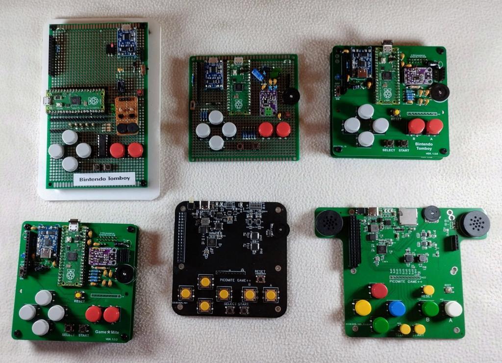

Posted: 09:32am 07 Dec 2023
Hi folks,
At this time of the year it's nice for family together and thanks to a generous gift from Peter they can:
Pity about the poor quality photo.
Top Left: Original prototype
Top Middle: 2nd prototype
Top Right: Pre-release
Bottom Left: Release v1.3.2 PCB
Bottom Middle: Peter's 2nd (?) prototype
Bottom Right: Peter's final (?) version
Thanks again Peter.
