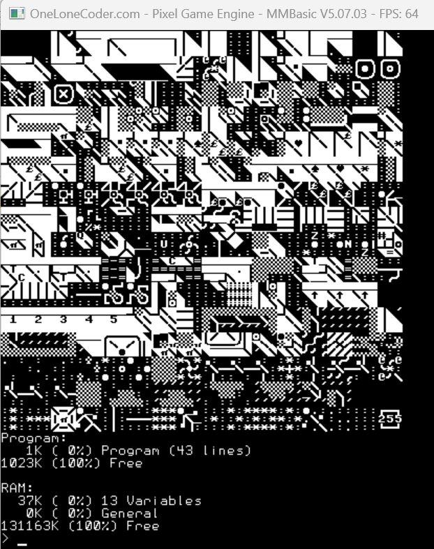

EDIT: This how the Tileset for the Game looks with C64 Font

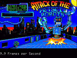

I don't know how pertinent it is here, but I was curious about the theoretical maximum scrolling speed for the ILI9341 (it may not be relevant, but CPUSPEED is 378000).
Martin's initial screen for PETSCII Robots seemed like a good start. Scrolling one column per iteration, it managed 9.9 frames per second.
Dim integer i,j,x,y,xx,yy
FRAMEBUFFER create
FRAMEBUFFER write F
Load image "b:\petscii-intro.bmp"
'Pause 5000
FRAMEBUFFER COPY F,N
FRAMEBUFFER WRITE N
CLS
xx=MM.HRes-1
yy=MM.VRes-1
Timer =0
For i=0 To xx
 FRAMEBUFFER BLIT F,N,i,0,0,0,xx-i,yy
 FRAMEBUFFER BLIT F,N,0,0,xx-i,0,i,yy
Next i
Print Str$((xx+1)/(Timer/1000),0,1)+" Frames per Second"
Text 0,MM.VRes-(MM.Info(FONTHEIGHT)*2),Str$((xx+1)/(Timer/1000),0,1)+" Frames per Second"

Posted: 12:36am 25 Sep 2023
Oops, sorry. Should be public now.

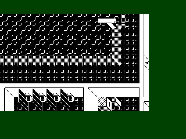

Proof of the SubTile-concept
(For Picomite VGA, for LCD remove the MODE Commands)
far from optimal (it redraws all Tiles every Frame):
Patscii_ascii.zip
with "GUI BITMAP" it outputs ~5 FPS.

Posted: 10:44am 25 Sep 2023
  Volhout said  since pico has not enough memory for a ILI9341 framebuffer, it uses the ILI9341 internal buffer. Through SPI bus.
Scolling the screen would require reading each pixel, and re-writing it in another location.
This would bring back the refresh rate to 2x76.8ms=154ms (or 6.5fps).
How is the observed horizontal scrolling rate of 9.9fps for the ILI9341 shown above compatible with a theoretical maximum of 6.5fps?

NB: reading from a display is much slower than writing
timer=0:blit 0,0,1,0,mm.hres-1,mm.vres:?timer
631.704
Edited 2023-09-25 20:47 by matherp
