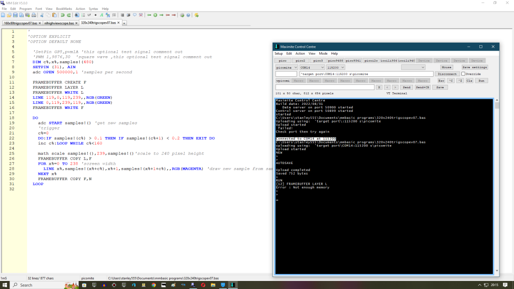

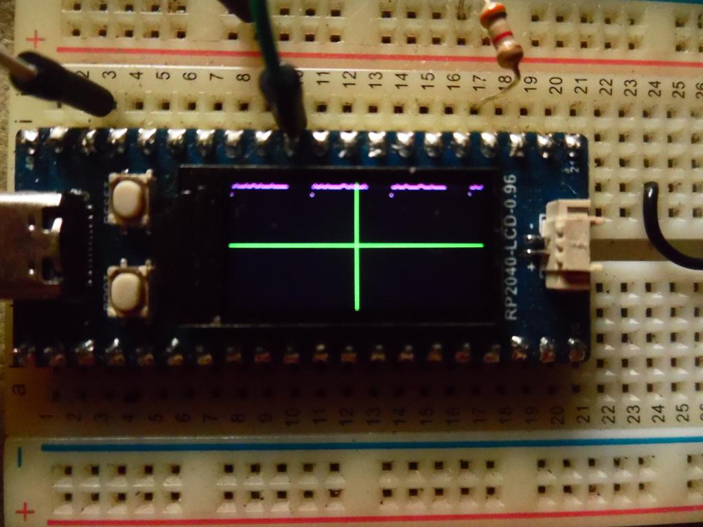

I removed trigger and used plot instead of line but just get a row of samples with flickering pixels for the rest?
 SetPin GP18,pwm1A 'this optional test signal comment out
 PWM 1,10000,30  'square wave ,this optional test signal comment out
 dim c%,x%,samples!(320)
 SETPIN (31), AIn
 adc open 500000,1 'samples per second
 FRAMEBUFFER CREATE F
 FRAMEBUFFER LAYER L
 FRAMEBUFFER WRITE L
 line 79,0,79,79,,rgb(green)
 line 0,39,159,39,,rgb(green)
 FRAMEBUFFER WRITE F
 do
   adc start samples!() 'get new samples
math scale samples!(),79,samples!()'scale to 80 pixel height
FRAMEBUFFER COPY L,F
for x%=0 to 159 'screen width
     pixel x%,samples!(x%),rgb(magenta) 'plot new sample
next x%
FRAMEBUFFER COPY F,N
loop

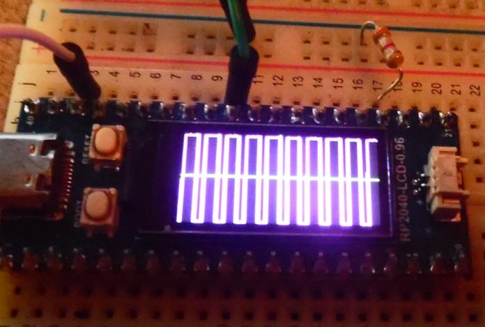

Posted: 07:47pm 17 Aug 2023
  Mixtel90 said  As the rising and falling edges of a PWM output are so fast on the Pico you probably shouldn't be able to see them. Probably not with a 500kHz ADC sampling rate anyway.  :)
Those edges are hardware generated on the chip and aren't related to the speed of MMBasic.
Hi Mick. er.. I can see them with join the samples with lines. Lines take more time than pixels and my prob is not realizing how fast everything is.
My crude trigger I can't find how to improve but a 9999Hz pwm doesn't move much.
It was never meant to be a real scope just a-d idea but I've learnt lots of new mmbasic stuff from this thread.
As mentioned, could be handy for breadboard testing... if no real scope handy.
could it be used for i2c,spi,pwm,serial testing. if the sampling rate was changed?
All input would be 3.3V. Maybe leave sampling at 500000 and if storing to array then pad out horizontal for lower frequencies for display, just a thought.
30KHz pwm 30%
Posts: 9251
Posted: 09:41pm 17 Aug 2023
Joining the samples with vertical lines is deceptive. The line thickness can represent several hundred microseconds on the display (it will actually depend on what your horizontal scale factor is). In actual fact the rise and fall times may only be a few microseconds. However, with edges that fast you can't see them on the display unless you make the horizontal zoom factor very big (only show one edge of the square wave, for example). Whatever you do on such a small display will be a compromise.
You can see this effect very nicely on an analogue scope. You won't see the rising and falling edges until you increase the brightness as they are too fast for the electron beam to put sufficient energy into the phosphor of the tube.

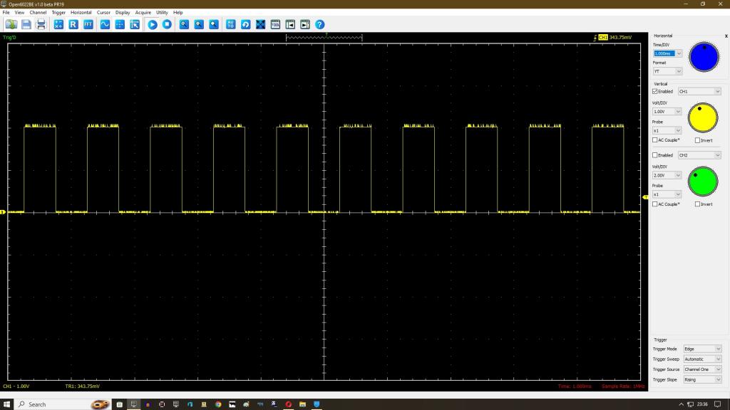

Posted: 10:48pm 17 Aug 2023
I saw an Asteroids board connected to a xy analogue scope in the 70's. wouldn't work without the phosphor on a sampling scope.
my cheap hantek usb scope shows vertical trace for digital signals

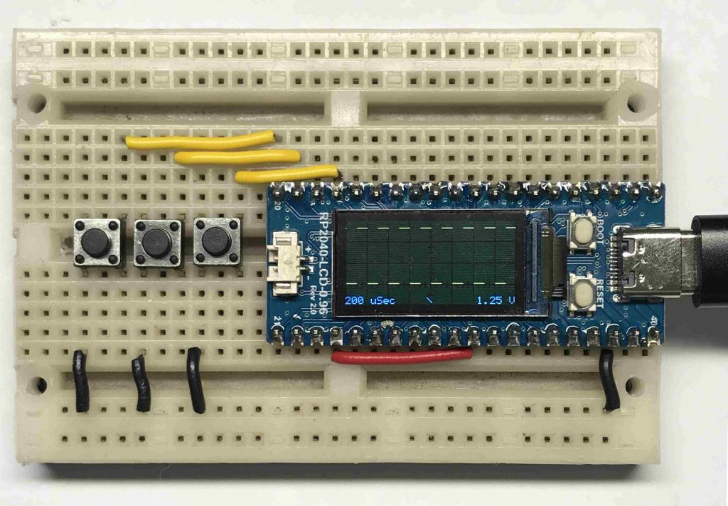

Hi - I've got three momentary-contact, pushbutton switches, one to cycle through time / ADC frequency, the next to select triggering, the the last to cycle through voltage ranges.  See my Handle_Pushbuttons subroutine.
Posts: 9251
Posted: 09:30pm 18 Aug 2023
That's very nice. :)
