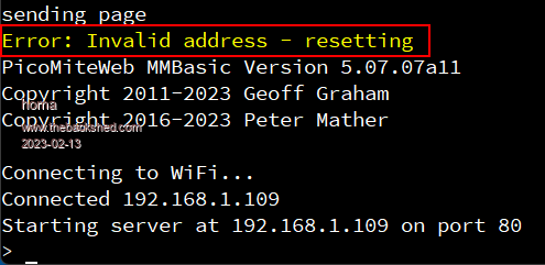

How did I manage to do that? (V5.07.07a11)
I tried sending direct input to the server in parallel with Tera Term on port 80 ... After closing this happened after 4-5 sec
I was wondering about the connection counter number 3 on my test website. And then came the error message.

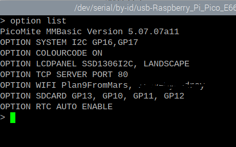

Hello All;
I have been able to configure all my peripherals to the point that they work on a11, although I must admit it took a while as I believe the order that the options are declared may make a difference but I have not tried different iterations to verify that case.
I have submitted a screen capture of my options;
Am I correct that the WIFI will not try and connect until you launch the console on the USB? The on board led flashes when the WiFi connects and does not do so if I just apply a power connection to the USB port. Does this mean that the web server cannot run without console?

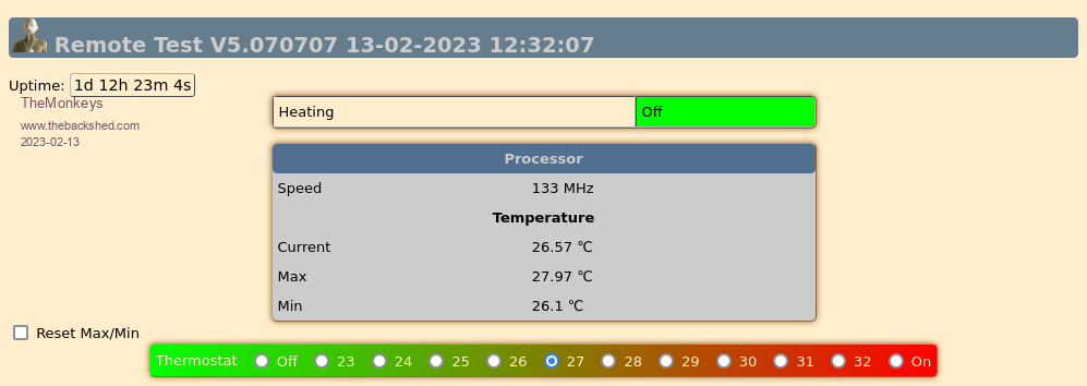

Just a little showing off...
uptime is calculated and displayed using dhms$(timer/1000)
dhmWHAT?
function dhms(secs%) as string
' take a decimal time and convert it to
' (d) (h) (m) s
' () = only appears as required
local integer s% = secs% mod 60
local integer m% = int(secs% / 60) mod 60
local integer h% = int(secs% / 3600) mod 24
local integer d% = int(secs% / 86400)
dhms$ = str$(s%)+"s"
if m% then dhms$ = srt$(m%)+"m "+dhms$
if h% then dhms$ = str$(h%)+"h "+dhms$
if d% then dhms$ = str$(d%)+"d "+dhms$
end function
first port of my php code library to basic.
As seen in the screenshot above, css and images are now supported.
I'll be adding javascript, although I intend to have a go at re-writing the page$ stuff to be more generally web-server compatible.
Yes, I'm running alpha 11 now.
Edited 2023-02-13 13:11 by TheMonkeys
