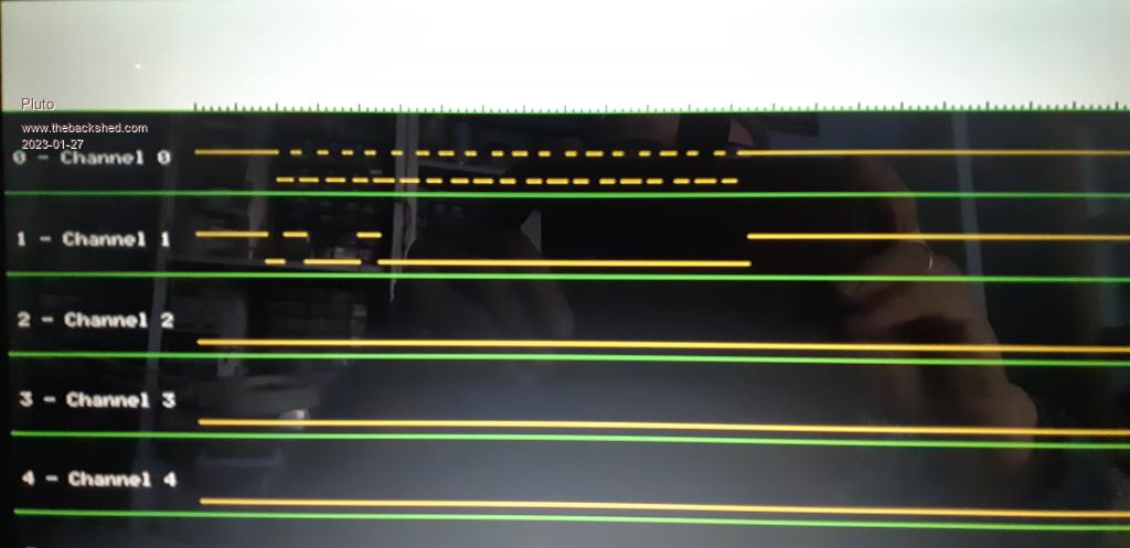

Combining Martin H's VGA idea and Volhout's PIO for Logic Analyzer:
PIO 1.0 @6MHz  PIO 1.1 @63MHz
samples% = 1024 (much more than needed for the part visible on the screen; scrolling of data in mind)
I had only a few GPIOs free on my PicoMiteVGA; using GP2 toGP7.
Picture: I2C to address &h48 with data &h00 , 400kHz. (ADT7410 I2C Temperature Sensor). I2C communication is running on a second PicoMite connected to the temperature sensor. The PicoMiteVGA-Logic Analyser is just listening to the SDA and SCL lines.
PIO 1.0 (collecting data) needs to be at min 6MHz in order to see the bits properly on the screen.
PIO 1.1 (trigger) is superb. Thanks Volhout!
Next step would be to try to scroll sidevise on the screen to see what the temperature sensor sends back. Decoding of the I2C (and other protocols) would also be nice.
Thanks to Peter, Volhout and Martin for your support and ideas!

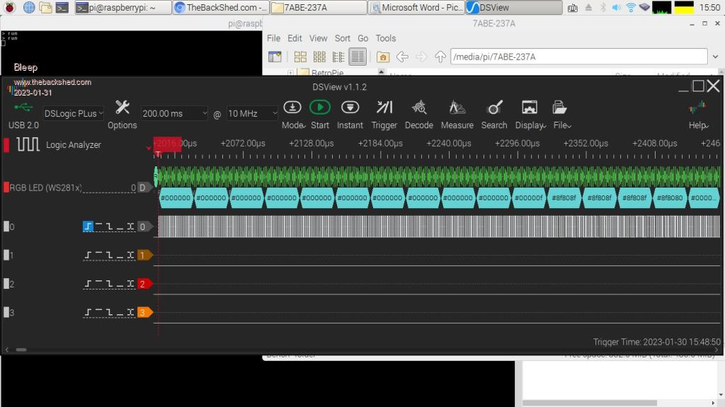

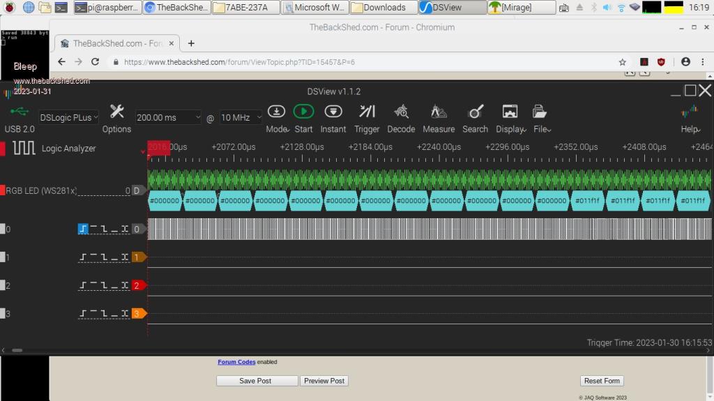

This produces the following logic sequence from the PIO
The first 12 LEDs are blank the the next 5 contain &H011F1F Which is correct.
When I change my code to use the DMA TX :-

I now get the logic sequence :-
Here the first 10 LED are blank and then the data is scrambled. It looks like the data is rotated or shifted in some way?
I've tried various other methods of packing the data, but so far, haven't managed to get the DMA TX to drive the LEDs correctly.
Any ideas/suggestions.

Volhout has hit the nail on the head :-) it was that the DMA was starting the PIO at the wrong point, re-initialising it for each data burst is now producing the correct bit sequence.
I do also like Peters suggestion of DMAing the data as 24bits (in a 32bit word) as I already create that and then discarding the extra 8 bits for each LED, it would save all the shifting and masking to get the 24bits sequentially packed into 32bit words, maybe my next challenge, but it could be tricky, to still keep the timing of the High/Low transitions within spec. (Anon. I just had a brain wave, can't you define how many bits are shifted out, before the autopull happens, I currently set this to 32, but maybe if I set it to 24???)

Hi Peter Volhout,
That's worked :-) I have had to move the RGB data up by 8 bits, in my display array, which I can do while filling it, but then all I have to do is PACK it and set the PIO to auto pull after 24 bits so the last 8 bits are discarded. So I've, or rather Peter, has managed to get rid of a whole load of byte shuffling, very pleasing. :-)
And yes it's going significantly faster using the DMA. :-) So fast I had a crash, because the DMA had not finished sending, by the time the Basic was ready to send the next array of screen update!
Regards, Kevin.
