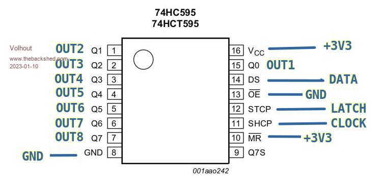

Fially I got the 74HC595 PIO program to work. Maybe not the most elegant solution.
'74HC595 Shift Register. Serial data in, paralell data out. FN 9.1.2023.
'***74HC595***
'Symbol                           Pin                       Description
'Q0, Q1, Q2, Q3, Q4, Q5, Q6, Q7   15, 1, 2, 3, 4, 5, 6, 7   parallel data output
'GND                              8                         ground (0 V)
'Q7S                              9                         serial data output
'MR                               10                        master reset (active LOW)
'SHCP                             11                        shift register clock input
'STCP                             12                        storage register clock input
'OE                               13                        output enable input (active LOW)
'DS                               14                        serial data input
'Q0                               15                        parallel data output 0
'VCC                              16                        supply voltage
'Connect MR to 3.3V.
'Connect OE to GND.
'disconnect ARM from GP0/1/2

Remains still a problem. LSB of the data is present on 74HC595 Q7 and MSB sets Q0.
Have struggled to get reverse order (LSB=Q0..MSB=Q7), but without success. I think this order would be more logical.

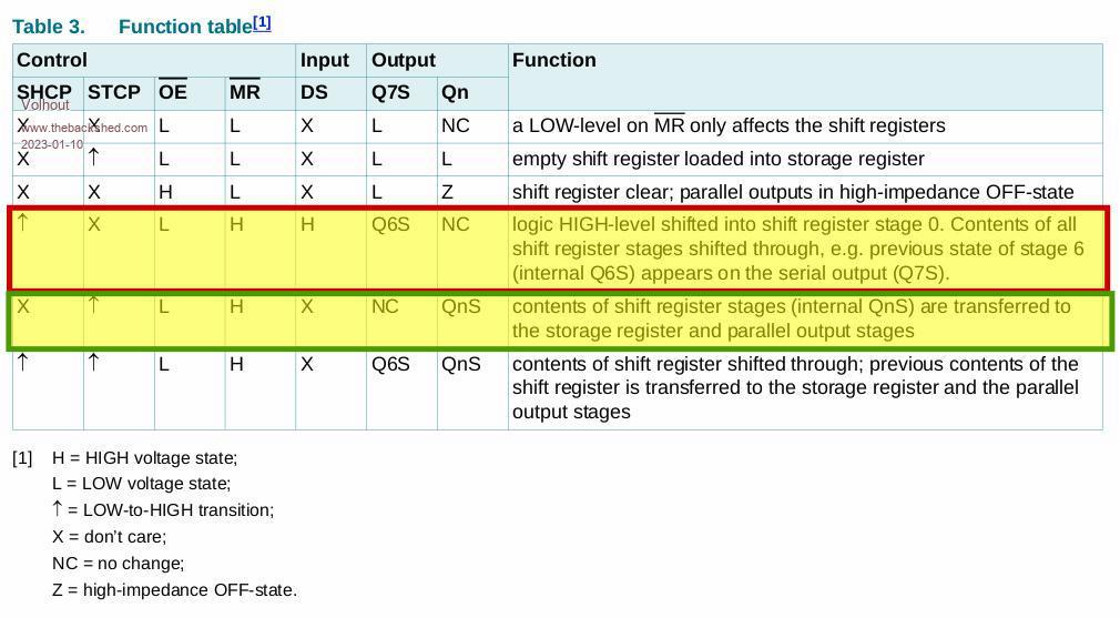

Chapter 10: Shift out data from OSR to a 74HC595 shift register
Serial peripherals can extend the functionality of a microcontroller. Such devices can be DAC's (digitial to analog converters), shift registers, but also ethernet chips. The PIO can assist in communication with these devices. For most, if not all, of these serial protocols, the OSR (Output Shift Register) is used. This is the output equivalent of the ISR (Input Shift Register) we have used in several earlier experiments.
Of coarse we need to write data into the OSR before it can shift data to the peripheral. The data path looks like this:
MMBasic ---> Output FIFO ---> OSR ----> GPx pins.
To get data into the output FIFO we use the MMBasic PIO WRITE function.
PIO WRITE a,b,c,d
a/ the PIO (in out examples PIO 1)
b/ the state machine (0...3)
c/ the number of 32 bit values to write (1..4)
d/ the integer variable that supplies the data (can be an array in case multiple 32 bit words are send).

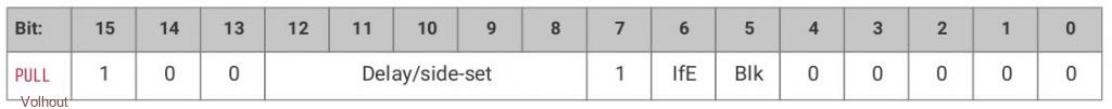

Once the data is written in the FIFO the PIO can fetch the data using the PULL instruction
The PULL instruction has a few flags and a delay parameter.
DELAY/SIDE SET : we have discussed this before
IfEMpty: we will not discuss this here
Block: When 1 the PULL instruction halts the PIO until there is data to pull from FIFO.
We have used the BLOCK flag in an earlier exercise where we generated the GATE signal for the frequency counter.
To shift data out to the IO pins, the OUT instruction is used. The paramaters are listed below.
DELAY/SIDE SET: already discussed earlier.
DESTINATION: "000" for PINS, "001" = X, "100" = PINDIRS, "011"=NULL (shift data lost)
BITCOUNT: the number of bits to shift out.
So it is pretty obvious to us how we can shift out 1 bit of data to pins. Use the OUT instruction, destination "000", and number of bit = 1
But there is something specific we need to do to assign a GPx pin to the OSR. The OUT instruction has it's own configuration in PINCTRL.
PINCTRL a,b,c,d,e,f,g
a/ number of side set pins
b/ number of set pins
c/ number of OUT pins.....this is new, we have neve used this before
d/ GP pin base for IN
e/ GP pin base for side set
f/ GP pin base for set
g/ GP pin base for OUT.....this is new, we have not used this before.
To explain how these puzzle pieces fit together we will explain using a concrete application: sending data to a 74HC595 shift register..
Similar to chapter 9 we will use the datasheet to determine how we can send serial data to the chip. The 74HC595 contains a set of 8 shift in registers, shifting happens on the rising edge of the SHCP (CLOCK)signal. The input data must be supplied to the DS (DATA) pin. Once all 8 bits are clocked in, the data is latched (frozen solid) into the 8 output registers at a rising edge fo the STCP (LATCH) signal.
When MRn is set low, the register is cleared. In out case we do not drive that pin, we tie it high, but many applications will use this pin to ensure a controlled power up (reset at power up). OEn must be low to provide data to the output pins.
Above information results in below connection diagram for the chip.
The PIO program to send data to the 74HC595 must do following:
'set CLOCK, LATCH, DATA to output
'set CLOCK=low, LATCH=low (and DATA=low)
'label1:
'set variable X (counter) to 7
'PULL data in OSR, blocking (halt here when no new data)
'label2:
'shift 1 bit OSR -> GPx (send data to 595 SER pin)
'generate CLOCK pulse (low->high->low)
'check X<>0 and JMP to label 2 when not 0, post decrement X
'generate LATCH pulse (low -> high -> low)
'JMP to label1

Let's assign GP pins: CLOCK = GP0, LATCH = GP1, DATA = GP2
GP0 and GP1 will be controlled from SET instructions, GP2 from the OUT instruction. So this gives following configuration(see above):
PINCTRL 0,2,1,,,GP0,GP2

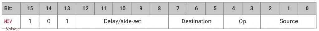

There is another possibility to set the pin direction of a pin. Use the OUT instruction itself. If you look above in the field description, you can see that the OUT instruction can also have PINDIRS as a destination. If you shift OUT a "1" into the PINDIRS, then the pin that is base for the OUT group (GP2 in our case) is also changed into an output.
OUT pindirs 1 = 011 00000 100 00001 = 0110 0000 1000 0001 = &h6081
But we can only shift a logic "1" out OSR when there is a logic "1" in OSR. So first we have to program OSR with a "1". That may not be easy, but we can (in 1 instruction) fill OSR with all 1's, by MOV'ing an inverted NULL in it.
DESTINATION: "111" = OSR
OPERATION: "01" = INVERT
SOURCE: "011" = NULL
MOV -NULL-> OSR = 101 00000 111 01 011 = 1010 0000 1110 1011 = &hA0EB

This code works well, but "wastes" 24 of the 32 clock cycles sending useless data. There is a trick to avoid that. Once we have the data in OSR we can (in one instruction) shift 24 bits into oblivion (called: NULL), and shift the remaining 8 bits to the 74HC595.
DESTINATION = "011" = NULL
BITS = "11000" = 24
OUT OSR->NULL 24 = 011 00000 011 11000 = 0110 0000 0111 1000 = &h6078

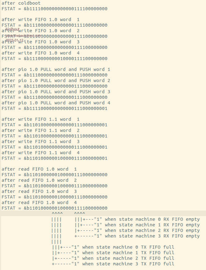

I wrote a small program that writes and reads data from the FIFO's to check the behaviour of the flags in FSTAT.

'check FSTAT behaviour when writing and pulling data
 print "after coldboot"
 print "FSTAT = &b"+bin$(PIO(FSTAT 1))
 print
 for i=1 to 4
   pio write 1,0,1,d%
   print "after write FIFO 1.0 word ";i
 next i
 print
 for i=1 to 4
   pin(gp0)=1:pause 10:pin(gp0)=0:pause 10
   print "after pio 1.0 PULL word and PUSH word";i
 next i
 print
 for i=1 to 4
   pio write 1,1,1,d%
   print "after write FIFO 1.1 word ";i
 next i
 print
 for i=1 to 4
   pio read 1,0,1,d%
   print "after read FIFO 1.0 word ";i
 next i
end

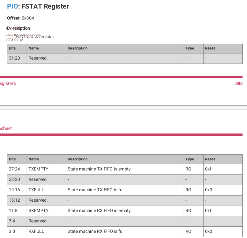

There are 8 flags that sound usable to me:
4 flags (one for each state machine) that show when there is data in the FIFO's to read from MMBasic:
RX_FIFO_empty = 1 , not empty = 0
So at a logical zero, you can read data from FIFO
4 flags (one for each state machine) that show when you can write data to the FIFO because it is not full.
TX_FIRO_full = 1, not full = 0
So at a logical zero, you can write data to FIFO

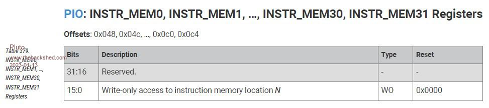

PIO DEBUGGING.
I tried to find a way to read the PIO program instructions from the program memory.
Did not find any direct way to do it. Noticed however that there are two registers from which it is possible to get the latest instruction number and instruction.
"Current instruction address:"  HEX$(PEEK(WORD( &h503000d4)))
"Current state machine instruction:"  HEX$(PEEK(WORD( &h503000d8)))
First attempts to read these registers while PIO was running caused problems due to the fact that during the time you read one of the registers PIO might have already moved to the following. For this reason the PIO is stopped before reading both registers and restarted afterwards.
Low PIO frequency makes it easier for MMBasic to catch the PIO instructions.
Run the program and stop it after a while when you see that it has got some fish in the net. Then run the PrintProg subroutine from console and you get a proper(?) listing of the program running in the PIO.

Posts: 6200
Posted: 05:01pm 12 Jan 2023
Hi Pluto,
The pio program is memory mapped in the ARM memory map. Check the list of PIO registers in the RP2040 datasheet, and you will find all 32 memory locations. A simple set of 32 successive peek(word address) will list the whole pio program.
But nice, you made a start for a disassembler..good
P.s. would you be willing to look at Mixtels PASM pio assembler. It worked in earlier versions of mmbasic, but needs some debugging in current.
Edited 2023-01-13 03:07 by Volhout
Pluto
Joined: 09/06/2017
Location: Finland
Posts: 421
Posted: 05:23pm 12 Jan 2023
@volhout.
Wish I asked about the program
memory before!
Pluto
Joined: 09/06/2017
Location: Finland
Posts: 421
Posted: 06:26pm 12 Jan 2023
I hope you did not mean these.
Write-only access to instruction memory location N.
I have tried to read, but all I get is 0.
I did not find any other locations.
disco4now
Joined: 18/12/2014
Posts: 1159
Posted: 09:43pm 12 Jan 2023
Hi @volhout,
A solution to your problem with FIFO being full at program restart might be here.
The FJOIN_RX and FJOIN_TX bits in the PINCTRL register description below.
When 1, RX FIFO steals the TX FIFO’s storage, and
becomes twice as deep.
TX FIFO is disabled as a result (always reads as both full
and empty).
FIFOs are flushed when this bit is changed.
Putting a POKE to set the bit and another to clear it at the start of the program should have the affect of clearing the FIFOs
PS. This tutorial has been really good. Thanks!
Gerry
Edited 2023-01-13 07:44 by disco4now
F4 H7FotSF4xGT
Posts: 6200
Posted: 10:36pm 12 Jan 2023
@pluto, i didn't see they where RO.
Sorry
@disco4now: good find, peter may use that to clear them.
Posts: 3418
Posted: 10:54pm 12 Jan 2023
Something like this for PIO 1,0 ?
addr% = &H50300000 + &H0D0
POKE BYTE addr%, 1
POKE BYTE addr%, 0
