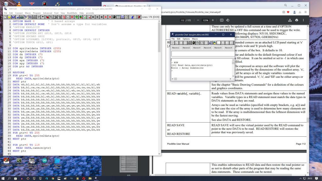

I tried running some code written in mmedit and click the running man and it saves and gives error messages which I've got to read data to array... it says - error array dimensions. I don't have a clue what's wrong.
Posted: 08:07pm 05 Aug 2022
cannon is not dimmed.
If you provide code with an error, please provide the line number of the error.

Posted: 08:50pm 05 Aug 2022
> RUN
[8] Read data,sp1(ptr)
Error : Array dimensions
OPTION BASE 0        ' 0 based arrays
OPTION DEFAULT NONE  ' Don't assume a type for variables
'OPTION EXPLICIT

not a clu and amazed mmeditworked, well seems to.. running man button to save and run.
Posted: 09:02pm 05 Aug 2022
sp1 is not an array. You've defined an array named "integer".
Posted: 09:04pm 05 Aug 2022
  Quote  dim sp1 integer (255)
Read the manual for DIM. This is meaningless.

Posted: 09:56pm 05 Aug 2022
for ptr=0 to 255
read sp1(ptr)
next ptr
you were reading two values on each pass, one into a variable called data and the second into the array.

Posted: 10:24pm 05 Aug 2022
It's not
READ DATA,...
but just
READ ...
