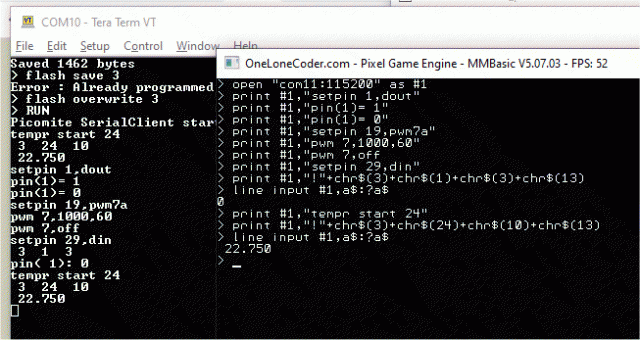

The addition of the EXECUTE command makes a Picomite serial client almost trivial. All regular basic I/O-related commands can simply be sent over serial and EXECUTEd. The only commands which need special handling are those which return values: DIN, AIN, CIN, FIN, PIN, TEMPR.
' serialClient.bas acts on serial messages
' if first character is "!", text data is to be returned, CR terminate
'   otherwise, single command is to be run with "EXECUTE"
OPTION AUTORUN ON
dim integer msg(3)
dim string cmd
pause 2000
print "Picomite SerialClient starting"
SetPin 22,21,com1 ' setpin 21,uart0tx:SetPin 22,uart0rx
open "com1:115200, 256, SerInt, 4" As #1 ' interrupt triggered with 4 characters
DO ' the program loops forever
WATCHDOG 2000 ' this will recover from errors
LOOP
SUB SerInt ' received a message
msg(0)=asc(input$(1,#1))
if chr$(msg(0)) <> "!" then
  pause 30 ' allow all characters in command to arrive
  line input #1,cmd
  cmd=chr$(msg(0))+cmd ' input$(255, #1)
  print cmd
  EXECUTE cmd
else ' function call will return data
  msg(0)=asc(input$(1,#1)): msg(1)=asc(input$(1,#1)): msg(2)=asc(input$(1,#1))
  print msg(0);" ";msg(1);" ";msg(2);" "
  if msg(0) = 3 then ' the command must be 3
    if msg(2) = 10 then ' DS18B20
'        s$ = mid$(str$(tempr(pin(msg(1)),3,3) + Space$(12),1,12) ' get the temperature
      s$ = str$(tempr(pin(msg(1))),3,3) ' get the input on the I/O pin
      print s$
    else ' value of DIN, AIN, CIN, FIN, PIN pin
'        s$ = mid$(str$(pin(msg(1))) + Space$(12),1,12) ' get the input on the I/O pin
