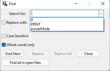

Posted: 05:03am 19 Apr 2022
I have updated the MMEdit5 files on my website (except RPi)
I will get my RPi sorted out again soon..
There are a few small tweaks including one for Brian:
Find searches are now remembered between sessions.

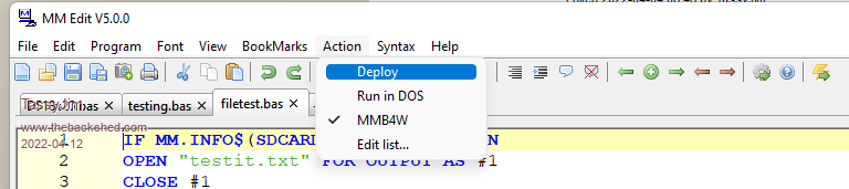

Hi there,
with the fresh version 2022/04/19
I do not see MMB4W option in Action menu.
Sorry, solved
Edited 2022-04-22 16:17 by Kabron
Posted: 06:17am 22 Apr 2022
  Kabron said  Hi there,
You have to add it.
MMEdit has no idea where you put the exe.

Posted: 11:36am 27 Apr 2022
Hi Jim
Remembering the file searches in Find is great, but out of interest, how do you clear the list?
Brian
