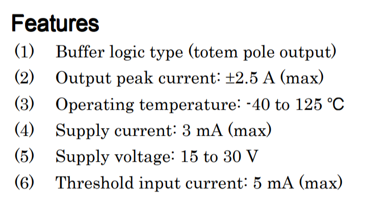

Just had a look at the data sheet. Interesting chip, but the output power dissipation is only 260mW. The output seems to drop about 2.5V (which seems high to me). If that's true then the *continuous* output current is only about 100mA, even though it can handle over 2A peak current. I couldn't see a continuous current rating anywhere on the data sheet. It's a nice driver but won't give the voltage to overcome Vgs in this case. It would be fun to try one but it might cook. :)

Continous current had me scratching my head, also. I have a handful of these things, will see if I can grab the time to load them up, over the weekend. I have 2A, 24v solenoid valves which should be a good test

Refer to Note 2 in the spec sheet, these are not suitable for driving a large current for a long duration.

  PeterB said  Tinine, correct me if I'm wrong but the TLP350H is a simple opto isolator similar to the 4N25 etc and, as such, will not produce the +ve voltage required by Bob's P chan. FETS.
@Mixtel90 and I are a bit befuddled by the lack of a continuous current rating but the peak is claimed to be up to 2.5A
All I have found is references to this device being PWM driven.
Wouldn't this mean that every pulse would be peak current? I dunno but I have a handful of these devices to test over the weekend. Am I being over-optimistic/naive in expecting these devices to be able to drive Bob's load directly?

Check out the conditions for the 2.5A (note 2)
Note 2: Exponential waveform. Pulse width < 0.3 us, f < 15 kHz
If I'm not badly mistaken, both the TLP350H and VOM1271 are drivers not load switching devices. The VOM1271 may be able to drive Bob's MOSFETs but not drive the load directly. Beware, if you let the magic smoke out it won't go back in.

Posted: 03:27am 06 Aug 2021
TLP350: those ratings are specified for driving a capacitive load with a very short duration, not for constant load. Its all in the spec sheet.
Note 2: Exponential waveform pulse width PW < 0.3uS, f < 15 kHz
Expected current pulse duration less than 300 nS
They will blow up running the led lights directly.
Mike

FETs are often thought to be the ultimate solid state switch. They are not.
The big problem is the very large gate capacitance that has to be charged and discharged quickly and at the sort of frequencies these things run at, that can be a problem and leads to devices like the TLP350H which is designed to deal with that capacitance.
Peter
Posts: 3420
Posted: 04:22am 06 Aug 2021
" Its all in the spec sheet."
Yes, that goes for all semiconductors. The Max. ratings are Not the working ratings.
