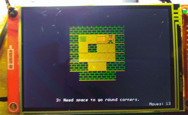

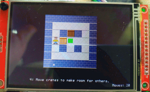

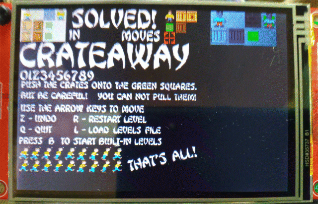

VegiPete's Crateaway on ILI9488 480x320
This provides an example of the BLIT LOAD command added in the latest PicoMite Firmware (since the faulty handling of MISO on the ILI9488 LCDs prevents the use of BLIT READ).
But the colors should be like this:
I feel like I've seen this problem before, but I don't remember the details.
capico.zip
When I do LOAD IMAGE "CrateAwaySprites480.bmp", the colors are correct.
With the following, the whites are yellow, perhaps as if blue is missing.
blit load 1,"CrateAwaySprites480.bmp",0,0,120,60

  Quote  With the following, the whites are yellow, perhaps as if blue is missing.
Tested on an ILI9341 and can't replicate. The above will fix one issue but can't see how it would affect a colour shift
Posted: 12:06pm 26 Jul 2021

And still no blue for an ILI9488. Any idea why that might be? (Mixing the 320 and 480 versions of the BMP makes no difference.)
Back to the ILI9488 and the 320 version also has no blue for BLIT LOAD, BLIT WRITE combination but LOAD IMAGE "CrateAwaySprites320.bmp" is correct, as is LOAD IMAGE "CrateAwaySprites480.bmp"
Posts: 12084
Posted: 12:29pm 26 Jul 2021
  Quote  And still no blue for an ILI9488.
Please try the attached - the red and blue may be reversed but that is easy to fix.
ILI9488test.zip
NB: I'm going to test fixing the ILI9488 problem using a 74LVC1G125GW
Edited 2021-07-26 22:33 by matherp
Posted: 01:58pm 26 Jul 2021
  matherp said  Please try the attached - the red and blue may be reversed but that is easy to fix.
This one appears to be missing yellow.
Main image, upper left, is of the 320x240 bmp. Upper right image is with 480 version after BLIT LOAD and BLIT WRITE.
  Quote  NB: I'm going to test fixing the ILI9488 problem using a 74LVC1G125GW
I've also ordered some SN74HC125N tri-state buffers to try to fix ILI9488 MISO to enable picomite BLIT READ, SAVE IMAGE based on a circuit I found.
Posts: 12084
Posted: 02:06pm 26 Jul 2021
One more try:
ILI9488test2.zip
Posted: 02:41pm 26 Jul 2021
  matherp said  One more try:
Perfect. Thank you.

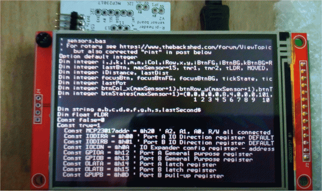

Here's a file viewer for the Picomite for a 480x320 ILI9488 display.
Font 1 is 8x12, which gives 40 60-character lines; Font 2 is 12x20, which gives 24 26-character lines (so font 2 is not very useful, but it works). Lines from the input file are truncated at 60 characters.
I implemented PgUp, PgDn, Home, End, Up Arrow, and Down Arrow. PgUp and PgDn move as many lines as are available on the display. Up Arrow and Down Arrow move the display up or down a single line.
I set OPTION CPUSPEED 250000.
Here's a 46-second youtube video
The re-writing of the whole screen with each keypress is, to my mind, pretty speedy.
I didn't write this because I thought it would in itself be of much value, but I wanted to see how quick it might be.
I hope Peter will reconsider his decision not to put keyboard functionality and SERIAL CONSOLE into the firmware as is available on the other Mites:
The Picomite is more capable than the MM2 and, except for number of pins, the MM+. It seems to me to be the best device with which to make an inexpensive stand-alone MMBasic computer--keyboard, LCD display, and still enough pins to do a lot of work or to experiment with.

The code displays the file, sensors.bas, provided in sensors.zip some posts previously, but it can display any basic program or other text file with CRLF delimiting.
