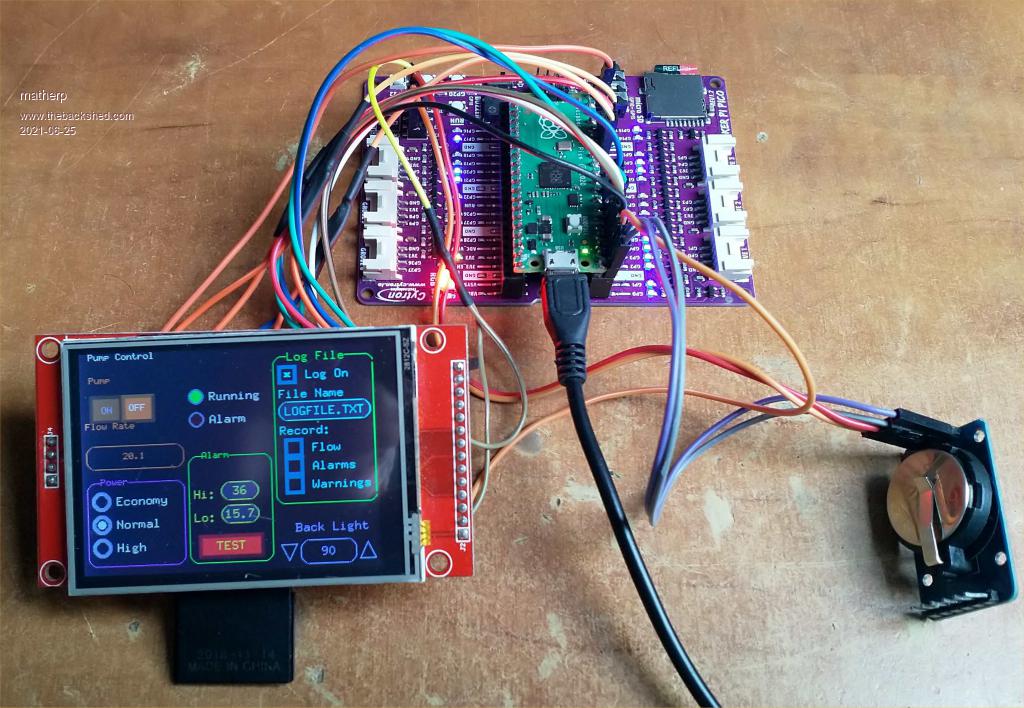

ILI9341 is sharing display & touch with SD card ok.
Clock is updating from DS3231 at boot ok.
OPTION AUTORUN 1 is loading & running the digital clock demo from the MicroMite manual.

a37
PicomiteV5.07.00a37.zip
NB: file replaced at 10:40 UTC
I think I've removed the bug from OPTION MEMORY
Full GUI functionality now implemented
DISTANCE function now implemented (Take care HR-SR04 need 5V and PicoMite pins are not 5V safe - use a level converter)
NB: FLASH commands should work OK independent of MEMORY setting. Flash spacing is always 80K but save and load are based on the setting of the MEMORY option

' using a select case command it has a different process for each
' control
Sub TouchDown
Select Case Touch(REF) ' find out the control touched
Case cb_enabled ' the enable check box
If CtrlVal(cb_enabled) Then
GUI Restore c_fname, tb_fname, c_log, cb_flow, cb_alarm, cb_warn
Else
GUI Disable c_fname, tb_fname, c_log, cb_flow, cb_alarm, cb_warn
Case sb_bright ' the brightness spin box
'BackLight CtrlVal(sb_bright)
Case sw_pmp ' the pump on/off switch
CtrlVal(led_run) = CtrlVal(sw_pmp)
CtrlVal(tb_flow) = Str$(CtrlVal(sw_pmp) * 20.1)
CtrlVal(r_norm) = 1
Case pb_test ' the alarm test button
CtrlVal(led_alarm) = 1
'GUI beep 250
Case r_econ ' the economy radio button
CtrlVal(tb_flow) = Str$(CtrlVal(sw_pmp) * 18.3)
Case r_norm ' the normal radio button
Case r_hi ' the high radio button
CtrlVal(tb_flow) = Str$(CtrlVal(sw_pmp) * 23.7)
End Select
' interrupt routine when the touch is removed
Sub TouchUp
Select Case Touch(LASTREF) ' use the last reference
Case pb_test ' was it the test button
CtrlVal(led_alarm) = 0 ' turn off the LED
End Select
  Quote  OPTION COLOURCODE ON
OPTION DISPLAY 32, 132
OPTION CPUSPEED (KHz) 250000
OPTION SDCARD GP15, 10
OPTION SYSTEM I2C GP0,GP1
OPTION LCDPANEL ILI9341, LANDSCAPE,GP2,GP3,GP4
OPTION RTC AUTO ENABLED
OPTION GUI CONTROLS 64
OPTION MEMORY 60160, 100352
OPTION TOUCH GP5,GP6
GUI CALIBRATE 0, 180, 210, 880, 644

That looks very nice:
Are the PIO state machines available for use in the Picomite basic routines.?
Mike
Posts: 9273
Posted: 11:59am 25 Jun 2021
I don't think Peter has even considered what to do with the state machines yet, Mike. He's been concentrating on making MMBasic work to the proposed spec. :)
