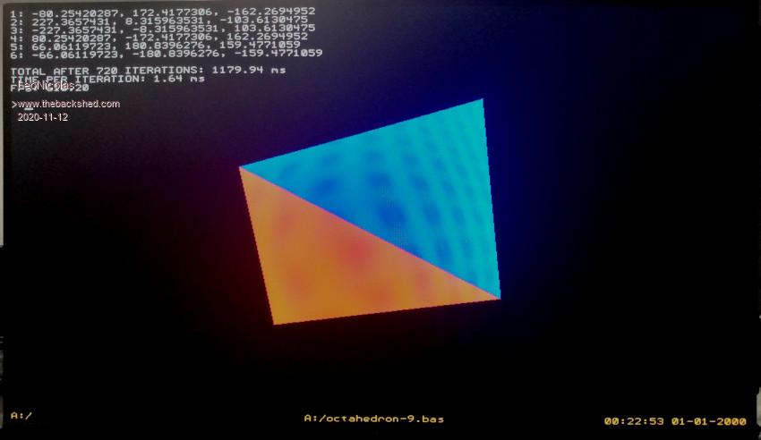

Posted: 02:56am 12 Nov 2020
Thank you lizby
This is my best time until now: 1179.94 ms
Adjusted time (x 1.18): 1392.32 ms
Firmware RC17
480MHz CMM2

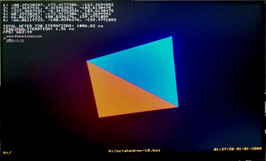

Posted: 04:15am 12 Nov 2020
Ok, I believe this will be my final version, I cannot see any new optimization, the code is very small, 64 lines only.
Total time: 1086.82 ms
Adjusted time (x 1.18): 1282.44 ms
Firmware RC17
480MHz CMM2
