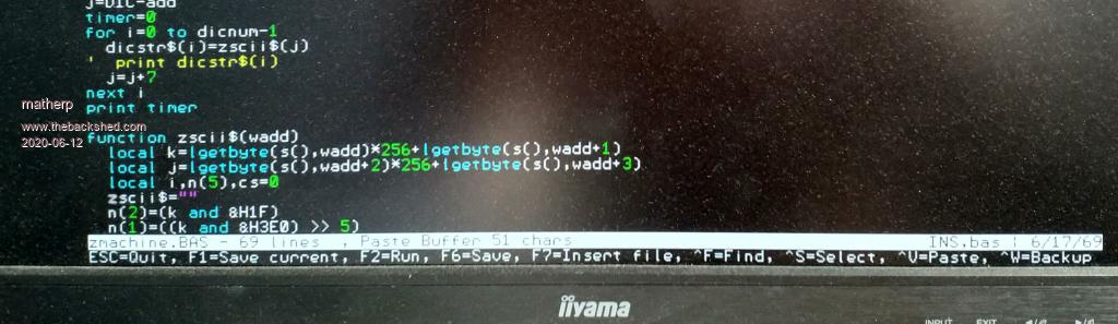

All
many thanks for keep trying to get to the bottom of the cut/paste issue.
The editor shows control characters in reverse video and the @ symbol is a 0. What is happening is that for some reason the number of characters in the buffer is getting incorrectly set so it is pasting beyond the end of the valid data and into the  zero initialised buffer - the question is why?
Please try the attached version V5.05.03b1e
http://geoffg.net/Downloads/Maximite/CMM2_Beta.zip
In it I've included on the status line the number of characters in the paste buffer
This should be equal to the number of characters that were highlighted + the number of CRLF end of line pairs. It gets set when you press F4 or F5 to cut or copy the buffer.
In addition I've included a check of the difference between my calculated buffer size and the length of the C string in the buffer - strlen(buffer). If these don't match then the number of chars is displayed as 999999
None of these changes should fix the problem but they may help you to diagnose when an issue has occurred. If you ever see the number of chars as 999999 then please let me know. In addition, if you see it, what happens if rather than pasting you do another selection? Does the error stay or does it self correct?
KeepIS
Joined: 13/10/2014
Posts: 2287
Posted: 08:48am 12 Jun 2020
If I try another selection, it does the same thing. Just now I tried to paste a line and got garbage, I tried to copy the same line and paste, different garbage.
Pressed SAVE this time and went back into edit, cleared the garbage and tried again to copy & paste, same problem. Pressed save again and went back into Edit, this time the copy & paste worked without error.
I'll download the Zip file now and install.

New firmware and spent some time before I got an error, however the behaviour has changed.
The Error is nothing was pasted, copied again and pasted, still nothing, did it a 3rd time and the line pasted, editor then worked correctly every time.
Difference this time, no garbage inserted. No 999999.
EDIT, forgot to add, the Paste Buffer said 23 chars which was correct but nothing pasted.
Mike
EDIT 2: Same thing again, worked the second time, correct buffer size and once again, no garbage anywhere and the editor was stable again. I have never NOT had garbage pasted or other effects, so something has indeed changed for the better.
Edited 2020-06-12 19:17 by KeepIS

Running new/new FW and was about to give up as all ok, however this time after a paste with nothing being pasted, I pressed F4 on a blank spot to clear the buffer, no chars in buffer display.
When I pressed enter key, the text that didn't paste was inserted and another small line of text near the copy point was also inserted, trying to edit was making a mess as every enter key press inserted more text, so aborted edit, went back in and all ok and could not get another error so far. Still no Zero or Esc chars showing up.
I've had this happen before but always followed by ESC and zero garbage.
I will have to go shortly, but I will try again tomorrow.
Mike.
